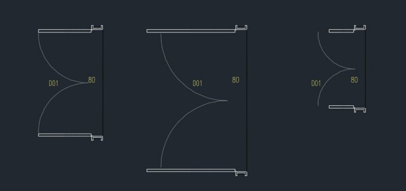

Hi Steven! Any chance I can get that step by step dynamic door file ?
I can stretch the double doors and opening width, but the swing line of the door panel doesn't seem to want to scale properly. When I scale the door back down, the swing line becomes bigger than the door panel. Any thoughts on what I'm doing wrong?

Looking at image on right the doors do not meet you have a gap. hence radius is say 1/2 gap is correct. Gets complicated making all the rules work.
Similarly, it looks as if the doors on the middle image are too long, rather than the arcs too small; obviously, this measns that the action on the doors is wrong, rather than the one on the swing...
