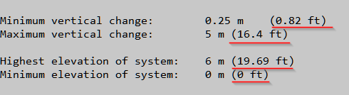

I m having this issue. I have some text that I want to have aligned. I m not talking about text in the model, I only talk about text printed (via prompt command) in the text window. I m having troubles to align it. Take a look at the following
I want to have the results of feet aligned. I am using the following to print the text using the \t.
(prompt (strcat "Minimum vertical change:        " (rtos minz 2 2) " m\t(" (rtos (m2ft minz) 2 2) " ft)\n"))
(prompt (strcat "Maximum vertical change:        " (rtos maxz 2 2) " m\t(" (rtos (m2ft maxz) 2 2) " ft)\n\n"))
(prompt (strcat "Highest elevation of system:    " (rtos highz 2 2) " m\t(" (rtos (m2ft highz) 2 2) " ft)\n"))
(prompt (strcat "Minimum elevation of system:    " (rtos lowz 2 2) " m\t(" (rtos (m2ft lowz) 2 2) " ft)\n\n"))
I was under the impression that the \t switch will tab all the lines under the same alignment. But regardless of many \t in a row I use, all are pushed equally unaligned. Do I miss something simple/basic here or do I need to elaborate with some custom-made code to do this?

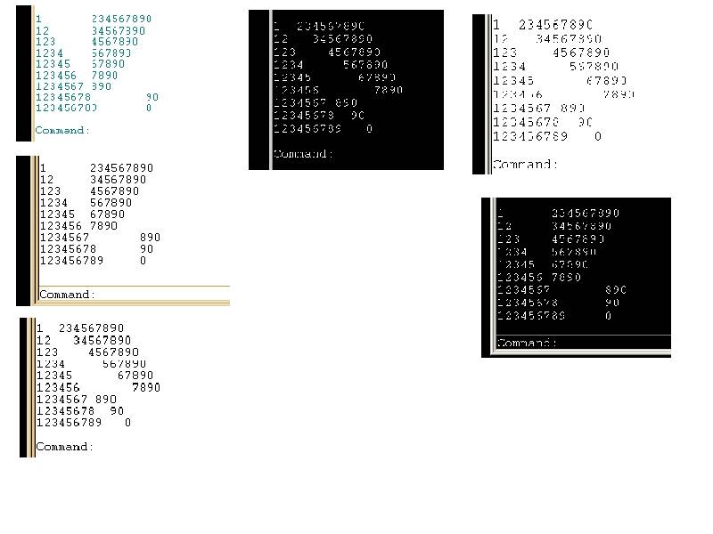

The tab character has always been flakey
Try this code :
 (textpage)
 (princ "\n1\t234567890")
 (princ "\n12\t34567890")
 (princ "\n123\t4567890")
 (princ "\n1234\t567890")
 (princ "\n12345\t67890")
 (princ "\n123456\t7890")
 (princ "\n1234567\t890")
 (princ "\n12345678\t90")
 (princ "\n123456789\t0")
The image attached is from various ACAD releases using the same code.
R12 -> 2012

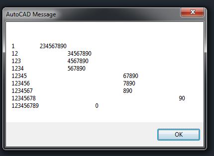

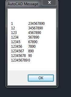

My version of Davids tested on 2013, side note what about a DCL ? Something to think about tabs stops are I think 8 characters wide so if you have text 9 characters wide you may need \t\t as per second code example.
(Alert (strcat "\n1\t234567890"
"\n12\t34567890"
"\n123\t4567890"
"\n1234\t567890"
"\n12345\t67890"
"\n123456\t7890"
"\n1234567\t890"
"\n12345678\t90"
"\n123456789\t0")
"\n12\t\t34567890"
"\n123\t\t4567890"
"\n1234\t\t567890"
"\n12345\t\t\t\t67890"
"\n123456\t\t\t\t7890"
"\n1234567\t\t\t\t890"
"\n12345678\t\t\t\t\t\t90"
"\n123456789\t\t\t0")

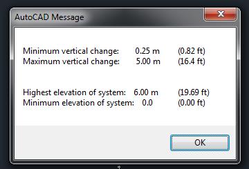

Ok had a play and found what I thought have a look at this and you can see the 0.0 on last line is pushed over you have 1 character to many so hit a tab spot try "Min." or "Elev."
(alert (strcat "Minimum vertical change:        " "0.25 m " "\t" (chr 40) "0.82 ft" (chr 41)
"\nMaximum vertical change:        " "5.00 m" "\t" (chr 40) "16.4 ft" (chr 41)
"\n\n"
"\nHighest elevation of system:    " "6.00 m" "\t" (CHR 40) "19.69 ft" (chr 41)
"\nMinimum elevation of system:    " "0.0" "\t" (chr 40) "0.00 ft" (chr 41)
