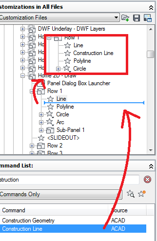

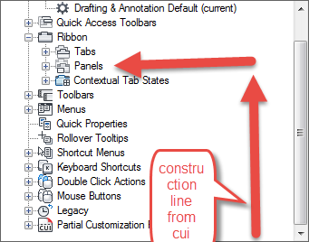

TheCADnoob Posted February 10, 2016 Posted February 10, 2016 Anybody has any luck for bring in CONSTRUCTION LINE on the ribbon home tab? it won't let me drag or paste. if you do please share. Just try to bring in the handy tool on the screen where it is easy to get to. Assuming i understand your problem, you cant drag into the tabs area, you have to drag into the panel area of the CUI. Quote

TheCADnoob Posted February 11, 2016 Posted February 11, 2016 all i want to do is that i want to have the construction line tool appear next to the line command in Modelspace environmentThis is the steps i did but not success: 1. I typed CUI 2. in the dialog box : i search for construction line 3. Drag construction line up drop in the Home, Ribbons or Panel (IT WON'T LET ME DROP TO ANY OF THOSE TABS) note: (I am aware that i can get the construction line under the draw drop down menu but i should n't do that, there is easier way to do this ) in 2014 Autocad i have the CONSTRUCTION LINE next to my LINE command. Are you expanding to the section you want? I have been able to do this on two different builds on two different machines Quote
TheCADnoob Posted February 11, 2016 Posted February 11, 2016 Also if this worked for you don't forget to change the look of the icon in the panel on the right. If you change it to large with text vertical it will look like this. Quote
