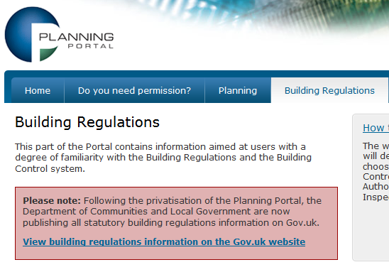

ReMark Posted February 5, 2016 Posted February 5, 2016 What would we do without the Internet? Take a peek at this....http://www.planningportal.gov.uk/buildingregulations/ Quote

nukecad Posted February 6, 2016 Posted February 6, 2016 I have done a bit of this before in the UK, as a sideline, and the planning portal as linked by ReMark was always my first stop when I needed to check the regulations. This has now been privatised, but you can still download the approved documents, which give you legal requirements for sizes, angles, distances, insulation requirements, fire safety, building access, ventilation, etc., etc., for free. http://www.planningportal.gov.uk/buildingregulations/approveddocuments/ Alternatively you can now download them from the governments own site: https://www.gov.uk/government/collections/approved-documents Structural regulations, including thickness of walls is in 'Approved Document A' but you need to be aware of a lot more than just that. Particulary for extensions you need to be looking at lighting and ventilation, soundproofing, stairways- angle of, height and going of treads, head clearance; drainage from bathrooms- size and fall of pipes, connections to existing sewarage arrangements; you get the idea. Most UK council planning departments have a range of leaflets about planning and regulations, and whether you need planning permission for a project or not. Most will also give a free initial meeting with homeowners considering extensions, and will comment on any problems with initial drawings. Don't expect them to tell you how do do them though, they will just point out where something you have done may not be to regulations. And as mentioned above check out your local council website; you can often view plans that have been approved in your area to give you an idea of the standard they are looking for. One thing not to forget is that whatever plans you draw up and get approved the builder will do something differently, its just the way of builders don't get upset about it. Quote
