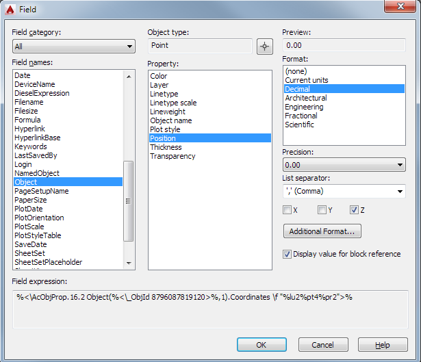

Is there anyway I can change the display numbers which is blocks to change 3 decimal to 2

I have use the microsurvey to create softdesk points, it form block for each point it display the point number elevation and description these elevations are 3 decimal I want to convert them to 2 decimal

Thanks, but for that I have to do one by one I have imported a top survey it has 250 to 300 points. It may take lots of time.

I see what you mean now.
I do not know of any way to change this globally when they are all distinct attributes.
What software did this get exported from? I'd say it is a matter of a setting in there before you export.

Thanks I tried that too. no setting it is microsurvey dca points even microsurvey help didn't reply anyway thanks lot.
Wait! There is one other option.
Edit the block to have a new attribute with a field. Set the field to an "object" and then the "position" and then the z value of the block (tick the box) and set to 2 decimal places.
Then remove the "ELEV" attribute and reposition the others so they are as you have them in your model.
Then save the block definition and run the ATTSYNC command (Name, Point, Yes).
I have attached a scren shot of the attribute settings and the dwg with the corrected number of decimal places. Will take about 5 minutes once you know how.new block 2.dwg
