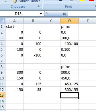

BIGAL Posted February 3, 2016 Share Posted February 3, 2016 If your doing closed shapes then just enter in excel the difference in X Y then you need to write a script from this entry or copy column. You need to use "concatenate" in excel. Quote Link to comment Share on other sites More sharing options...

BIGAL Posted February 4, 2016 Share Posted February 4, 2016 I blieve I understand you, a shape 3 side a shape 4 side a shape 5 sides you can not have a auto solution, (you can but not right now) you need to post a excel that means something not just var1 var2 var3 etc we dont have a clue. I am more than happy to say you can draw an object from excel data, but it must make sense. The example I posted as a beam 4 lines and holes in it just cahnge some numbers in excel and get next beam. Quote Link to comment Share on other sites More sharing options...

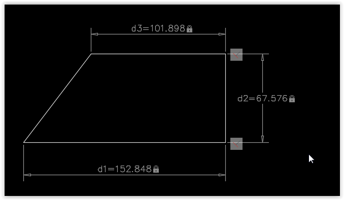

BIGAL Posted February 5, 2016 Share Posted February 5, 2016 Ok I realise now how to do it 3 steps and yes you can have single cell entries like 200 50 100 1 make a dynamic block for each basic shape 3, 4, 5 side etc 2 pretty sure Lee-mac has dynamic block update code 3 use something like getexcel.lsp to read spreadsheet see d1 d2 d3 these are your Vars I dont play with dynamic blocks so can not help much. Quote Link to comment Share on other sites More sharing options...
