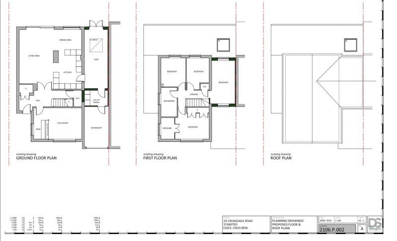

Caesium Posted January 26, 2016 Share Posted January 26, 2016 Hi all, I'm new to this as I am undertaking a self build extension and wanted to do my own drawings. I'm pretty much done with the drawing but when I set up the layout to A3 my drawing appears very small and I'm not sure how to make it fill the space. Also I need to add a scale and title block for the planners, something simple if anyone can help. Thank you all in advance. I have attached my drawing for you perusal. Floorplan PROPOSED.dwg Quote Link to comment Share on other sites More sharing options...

Caesium Posted January 26, 2016 Author Share Posted January 26, 2016 Scale of 1:100 as I think that's the accepted standard. I was going to attempt to and a border and scale information as well as a title box. All three drawings on the same A3 page is what I anticipated as I have a separate drawing for the existing building. Quote Link to comment Share on other sites More sharing options...
ReMark Posted January 26, 2016 Share Posted January 26, 2016 I think otherwise but you're the boss. Quote Link to comment Share on other sites More sharing options...
Caesium Posted January 26, 2016 Author Share Posted January 26, 2016 I'd welcome your opinion Quote Link to comment Share on other sites More sharing options...
ReMark Posted January 26, 2016 Share Posted January 26, 2016 Your three plan views on one sheet at a scale of 1:100. I added a border (in blue). The pale magenta colored box is the viewport frame situated on its own layer (set to "no print") and display locked. How much AutoCAD experience do you have? Quote Link to comment Share on other sites More sharing options...

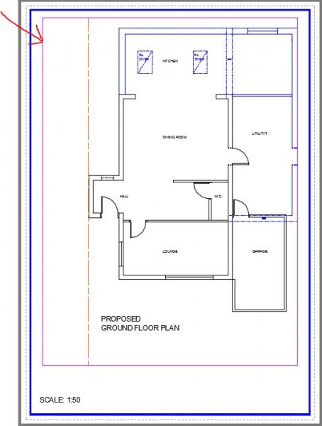

ReMark Posted January 26, 2016 Share Posted January 26, 2016 Another option is to put each plan view on its own sheet (one layout per view) like that shown below. Now you can use a scale of 1:50. Once again the pale magenta colored box is the viewport (no print - display locked). Quote Link to comment Share on other sites More sharing options...

Caesium Posted January 27, 2016 Author Share Posted January 27, 2016 Hi There, thanks for your efforts, I had been at work all day and if I sat at the screen much longer I'll go crazy. As for my AutoCAD experience, I have none except for the drawing you see before you. The reason for putting all three on one page is not for construction use, only for submission to planning dept. Was the drawing okay other than plotting it correctly on the paperspace? Sorry if my terminology is not up to scratch, I am not trained in AutoCAD, I'm a technical engineer for a telecoms company, not an architect Quote Link to comment Share on other sites More sharing options...
ReMark Posted January 27, 2016 Share Posted January 27, 2016 I reviewed your drawing strictly from the viewpoint of someone who works with AutoCAD on a daily basis. I can go back and take another look at the architectural aspect of it if you wish. From a CAD standpoint improvements could be made to the drawing but I take it that this is a "one off" and the likelihood of you doing any more drawings is small. Is that correct? Your planning department should have provided you with a "punch list" or sample drawing of what is required for submission. Didn't you receive anything from them? Some municipalities will post information online regarding what is required for a submission as well. Did you check? Quote Link to comment Share on other sites More sharing options...
ReMark Posted January 27, 2016 Share Posted January 27, 2016 (edited) I have some questions regarding your drawing from an architectural point of view. Ground floor -Why are the proposed external walls thicker than the existing external walls? -Are you actually going to remove/replace the back wall of the garage? -What are the two objects labeled "RL Over"? Are they skylights? -The utility room is quite large. What exactly will be located in this room? First floor -Why just one very large window in the bedroom? -You should probably show where the toilet, shower/bathtub, sink/vanity are going to be situated in the en suite. -Exterior wall thickeness? -How does one go from the ground floor to the first floor? I don't see a stairway. Roof plan -Could you explain what is going on with the roof? I'm not sure I understand. -What does the existing roof on the garage look like? Is it flat? Aren't you required to provide at least two elevations (front and side) in your submission? Edited January 27, 2016 by ReMark roof not room Quote Link to comment Share on other sites More sharing options...
Caesium Posted January 27, 2016 Author Share Posted January 27, 2016 I have some questions regarding your drawing from an architectural point of view.Ground floor -Why are the proposed external walls thicker than the existing external walls? Building code dictates that 100mm leaf with 100mm insulation then 100mm leaf hence the thickness. Existing house built before legislation introduced. -Are you actually going to remove/replace the back wall of the garage? There is a steel beam over the back of the garage to support the elevation above, Exisitng wall will just be plastered when it's inside. -What are the two objects labeled "RL Over"? Are they skylights? Yep -The utility room is quite large. What exactly will be located in this room? I am thinking about sub dividing this room and having a gym in the other half First floor -Why just one very large window in the bedroom? To match existing front window in main house, the side will overlook another property and probably will not be able to have any fenestration. -You should probably show where the toilet, shower/bathtub, sink/vanity are going to be situated in the en suite. Yes I can do this, thought about leaving that for now as the planners don't require it and it would be added to construction drawings. -Exterior wall thickeness? 300mm -How does one go from the ground floor to the first floor? I don't see a stairway. Still need to add this Roof plan -Could you explain what is going on with the roof? I'm not sure I understand. -What does the existing room on the garage look like? Is it flat? Yes Aren't you required to provide at least two elevations (front and side) in your submission? I have a few more things to add to the drawing, it just struck me that I might ask for advice before committing any more time to finishing the drawing if I couldn't print it due to a formatting error. if I'd made some catastrophic mistake in the scale and had to draw it all over again I'd be miffed so thought I'd ask the question before committing any more time, that's all. Here's some sketchups I thought I could use as elevations Quote Link to comment Share on other sites More sharing options...

ReMark Posted January 27, 2016 Share Posted January 27, 2016 Thanks for the images and for answering my questions. Quote Link to comment Share on other sites More sharing options...
Caesium Posted January 27, 2016 Author Share Posted January 27, 2016 Does it make sense? Quote Link to comment Share on other sites More sharing options...
ReMark Posted January 27, 2016 Share Posted January 27, 2016 For the most part it does. What type of insulation is being used in the exterior walls? I'll be curious as to what the addition of the stairway will do to the overall interior design. Quote Link to comment Share on other sites More sharing options...
Caesium Posted January 27, 2016 Author Share Posted January 27, 2016 100mm celotex most likely. Quote Link to comment Share on other sites More sharing options...
