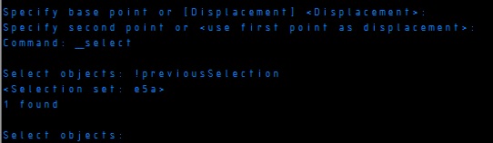

jonathann3891 Posted January 25, 2016 Posted January 25, 2016 This morning AutoCAD started acting weird and I cant figure out what happen. After certain commands like MOVE, AutoCAD is selecting last. Is there a system variable or something to disable this? Attached is a screen shot of my command line. Quote
rkmcswain Posted January 25, 2016 Posted January 25, 2016 So you did not manually enter "!previousSelection"? Quote
jonathann3891 Posted January 25, 2016 Author Posted January 25, 2016 No. Its doing that all on its own Quote

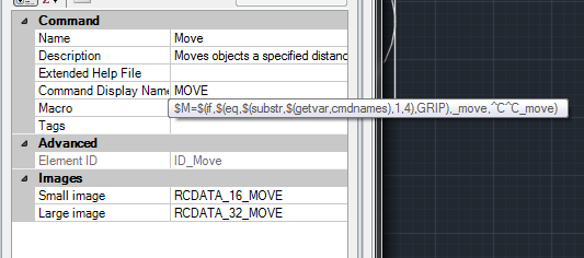

TheCADnoob Posted January 25, 2016 Posted January 25, 2016 what is the command string in your CUI? Should probably be something like : $M=$(if,$(eq,$(substr,$(getvar,cmdnames),1,4),GRIP),_move,^C^C_move) Quote

jonathann3891 Posted January 27, 2016 Author Posted January 27, 2016 what is the command string in your CUI? Should probably be something like : $M=$(if,$(eq,$(substr,$(getvar,cmdnames),1,4),GRIP),_move,^C^C_move) Yes, its exactly that! Quote
