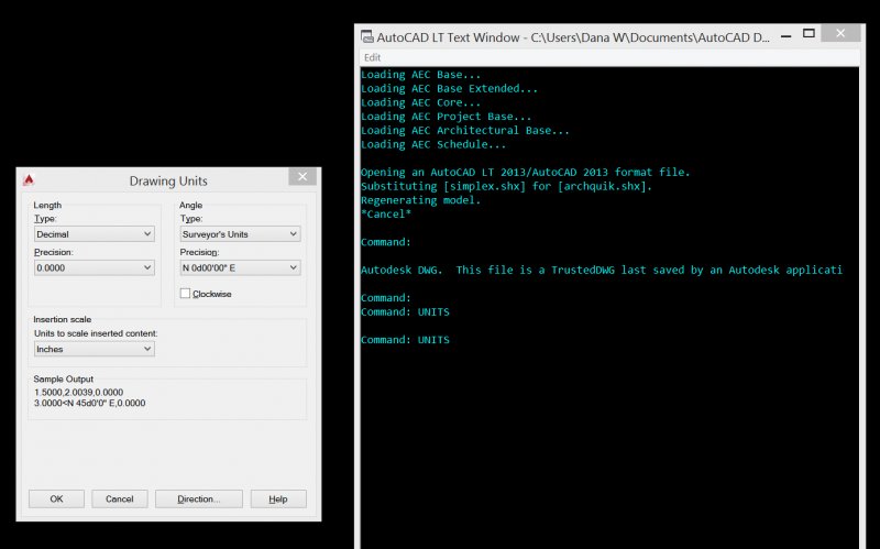

You should be able to enter, for instance, 29d12'4" at the command line for angle.
It would help to change the units for Angle Type to surveyors units, if you have not already.

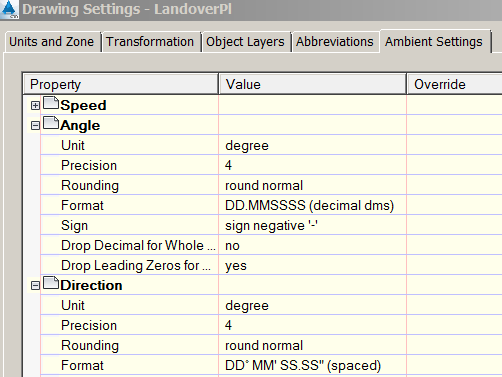

Tombu where is DDD.mmss ?
In a Civil 3D drawing or template Toolspace Settings tab right-click Active drawing name at the top and pick Edit Drawing Settings…
On the Ambient Settings tab expand both Angle & Direction and set the Format for each to DD.MMSSSS (decimal dms)
