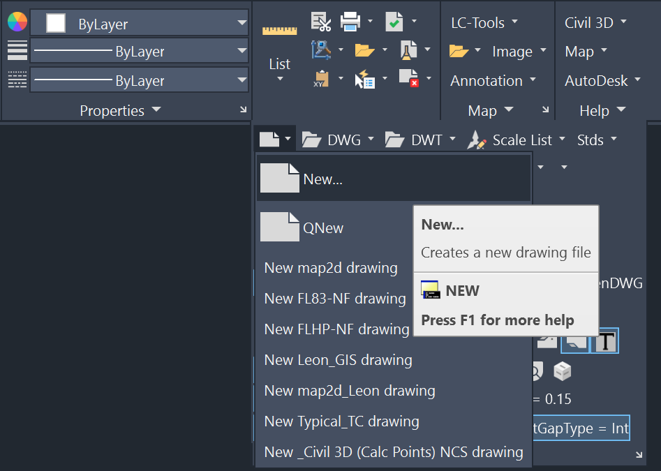

A few templates already set up can really reduce drawing time and eliminate needing to make modifications like Dimension Styles and linetypes.
We use a variety of templates for whatever workflow the job requires.
Ctrl+Home in AutoCAD takes you to the Start page to browse them or add the ones you use to a custom panel .
