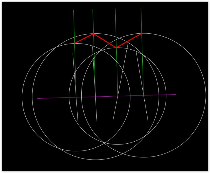

BIGAL Posted January 20, 2016 Posted January 20, 2016 A manual way draw a line over your contours where each line hits the contour create a perpendicular line from this point, draw a circle of radius = contour value say 18 make sure it crosses the perp lines, joint all the intersecting circle and line crossings that is your cross section. Yes a lisp way is to use ssget and a fence selection option then either a inters or Intersectwith to find intersecting point and then add the rl then draw a pline. Quote
