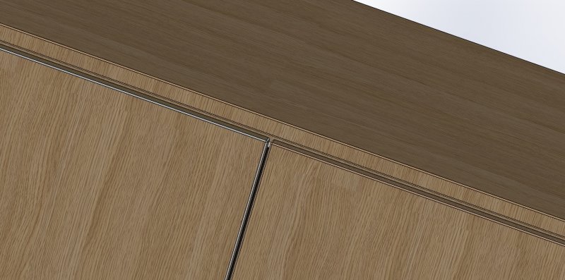

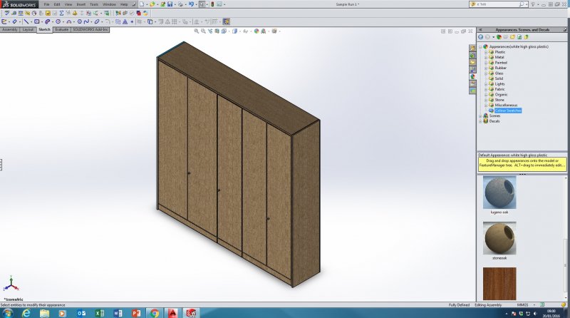

Sarah Jayne Posted January 20, 2016 Author Share Posted January 20, 2016 Hi shift1313, Thank you for your help, it is much appreciated! So I have now worked out how to make a p2p file and can now drag and drop my wood appearances onto my model. I was hoping that there was a way of making the orientation automatic, based on the location of the appearances, ( I presumed through some sort of mathematical coding which defines an orientation based on a face's size and configuration, but I guess that's not possible on SolidWorks!) I have attached some pictures to this post to try and illustrate what I mean by the coloured edging. The first picture is the whole set of cupboards to try and give you an idea of what I am doing. The second picture is a close up of the top of the doors, I have left the left hand door edging with no appearance applied and the right hand door edging has an appearance applied. I am hoping that there is a way of the colour of these edges changing based on my chosen wood grain for the faces... For example, with the wood grain seen in the second picture, the colour of the edging is similar to the wood colour . So like maybe there is a way to make it so that the colour of the edging is transformed automatically based on the wood grain I allocate to the face? Many thanks Sarah x P.s. Also does anyone know how to make the size of the grain for all faces the same just by dragging my appearance onto a face, at the moment it seems to be adjusting to the size of my faces! (A LOT of questions I know!) Quote Link to comment Share on other sites More sharing options...
