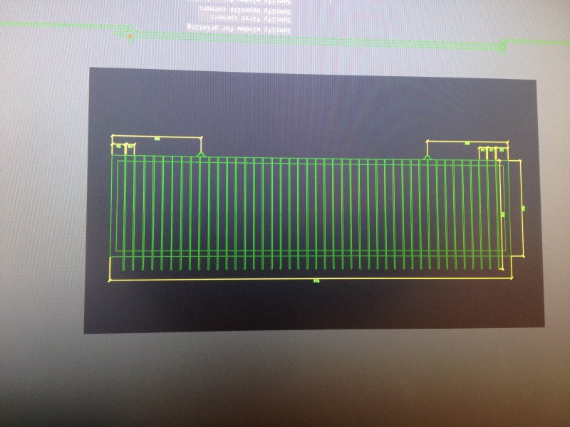

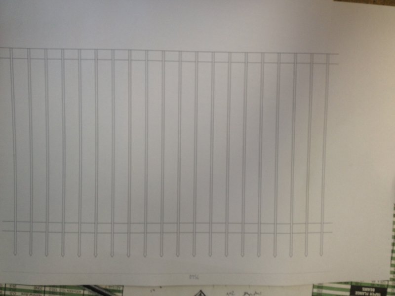

Bidgee Posted January 13, 2016 Posted January 13, 2016 Hi All, I'm having trouble printing a full page, I select window, the pick what I want, I preview it, its what I want, but then only prints abit over half of what I want. Any ideas? Is this a Auto Cad setting problem, or maybe printer? Works fine on A4, but not on A3. Thanks Quote

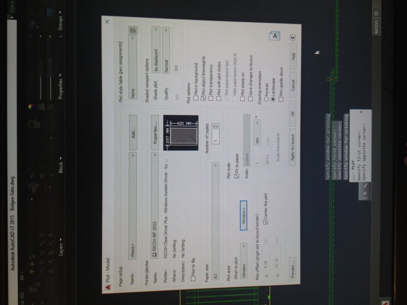

BIGAL Posted January 15, 2016 Posted January 15, 2016 Screen grab your Autocad plot settings and post here. Quote
Bidgee Posted January 15, 2016 Author Posted January 15, 2016 This shows my window I picked, the result on paper, and plot settings. Quote

BIGAL Posted January 16, 2016 Posted January 16, 2016 As I said in my 1st post check outside of Autocad, Windows Devices and Printers check that the default printer settings are set to a A3 not A4 the default will over ride Autocad sometimes. 1 1 Quote

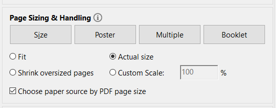

mhupp Posted October 29, 2022 Posted October 29, 2022 On 1/16/2016 at 6:09 PM, BIGAL said: As I said in my 1st post check outside of Autocad, Windows Devices and Printers check that the default printer settings are set to a A3 not A4 the default will over ride Autocad sometimes. If your using adobe reader make sure these options are checked. Quote
