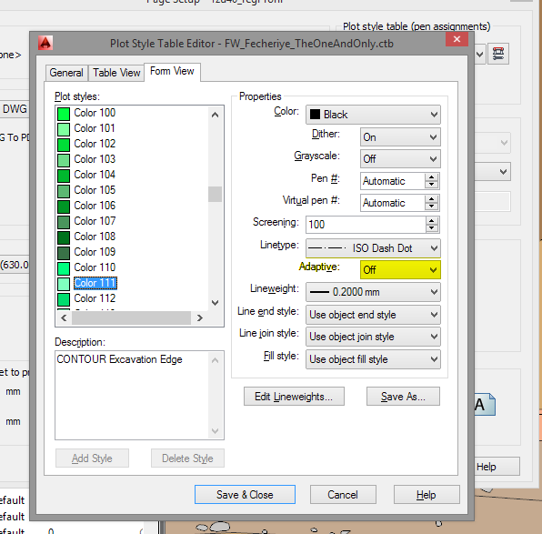

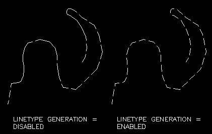

i have a dashdot linetype in my plot, but due to several curves in the pline it plots the spaces/gaps between the dots and lines irrregular (see attached image). how can i change this to a more regular appearance? (acad 2016)

hey rkmcswain,
thanks for your help, but this did workin an test drawing, but not in my existing one. could it be that this doesnt work, if the dash-dot style is assigned by a color dependant plot style?
EDIT: okay i found out, you have to turn the dropdown "Adaptive" to "Off" - now it works.
