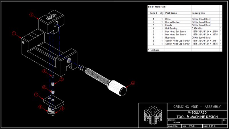

ReMark Posted January 10, 2016 Share Posted January 10, 2016 Found this exploded view I did of a machinist's pin vise for a 3D AutoCAD class I took. Quote Link to comment Share on other sites More sharing options...

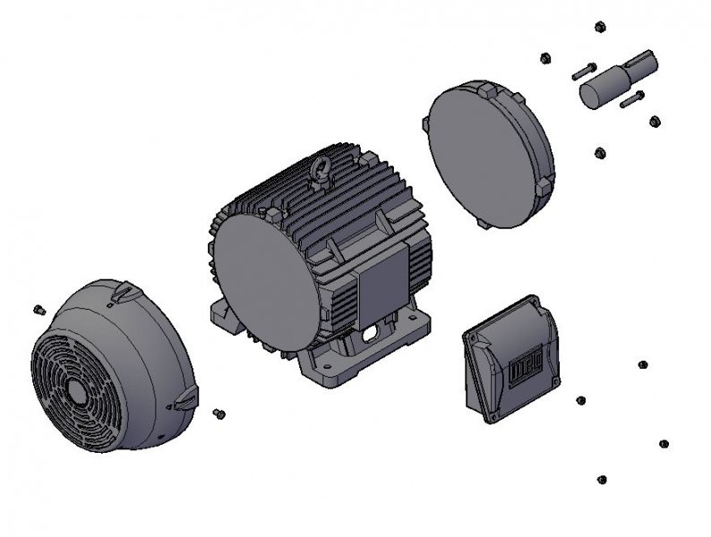

ReMark Posted January 11, 2016 Share Posted January 11, 2016 I've never heard the phrase "installation" drawing. I All I know is that my exploded assembly drawing looks very similar to the image you posted. I do not have a similar drawing for a motor or a load cell but I don't see why you couldn't create one yourself. Quote Link to comment Share on other sites More sharing options...
ReMark Posted January 11, 2016 Share Posted January 11, 2016 I looked through my 3D drawings from outside vendors and found a drawing of a motor which I then disassembled into its individual parts to mimic an exploded view. The result is shown below. Quote Link to comment Share on other sites More sharing options...
