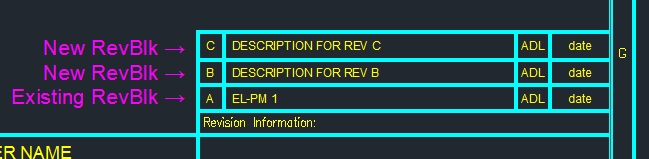

We are looking for a way to revise multiple layout tabs (single .dwg file) at one time.
We design our product in 2D in one .dwg file. We use the layout tabs for multiple views of the objects that are in modelspace, (each layout tab has the project titleblock on it, but each layout tab has its own set of revision blocks.)
We "stack" the revision blocks in the Y direction, please see first screenshot)
There are times in the project when ALL layout tabs need the same revision description. For example, Issue for Construction, P.E. comments, As Built... etc. This was previously done by inserting the RevBlk, editing attributes, Copy-Basepoint, switching to each layout tab, and pasting above the existing RevBlk.
So we would like to be able to insert a revision block into each layout tab using a dialog box or excel.
Explained simply (hopefully): The routine would find the revision block (RevBlk) with the largest Y value (because we "stack" the revision blocks in the Y direction, please see example) and insert a new revision block (RevBlk) above it. The height (in Y direction) of the block is .1271, so the new RevBlk would need it's insertion point @0,.1271,0 in relation to the existing RevBlk with the highest Y value. Please see first screenshot:

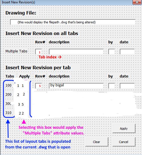

It would be nice if we could control the insertion of new revisions from a dialog box:
(the routine would need to detect what tabs were available?)
I'm sorry for the way it looks, the only way I know how to make one is in Excel's VBA
Also, I have a grander vision to define project parameters in Excel and then the appropriate blocks will be inserted (from the block library) into the new .dwg file.
So I'm hoping this smaller task will help me along with the larger endeavor.

It will insert another RevBlock above the previous one, on all layout tabs. So it's a big step in the right direction.

Pbe re dcl maybe look at the layouts as a dcl scroll list but display the name and current revison bit like a dotted pair. Pick one and enables the single edit boxes. Thinking a bit more maybe Layoutname current-rev newrev in listbox, then a update button, so you can scroll up and own before actually doing the changes. The third bit like 1st update all is to update range.

....Pick one and enables the single edit boxes. Thinking a bit more maybe Layoutname current-rev newrev in listbox, then a update button, so you can scroll up and own before actually doing the changes....
Sounds like a plan, all we need now is somebody to start building the dialog box. we will add options to ronjonp's program. Easy cheesy.

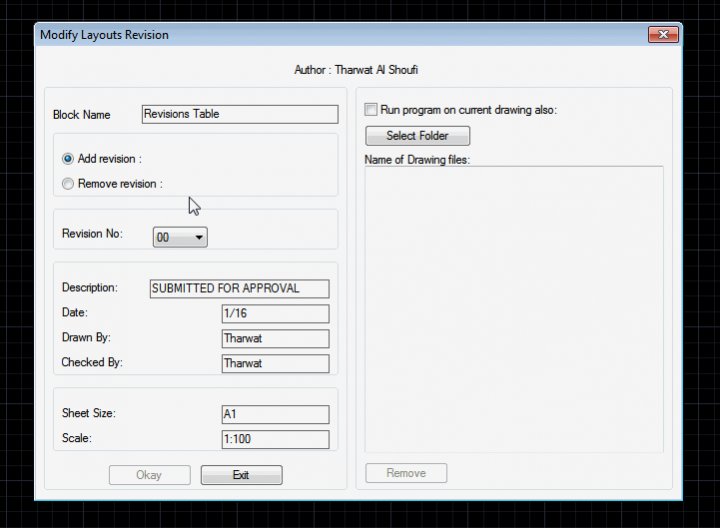

Have a play with this program that I have just finished from writing it for you for sure :) so try it and let me know.
Firstly add the following DCL into your support folder then run the program .

Hallo Tharwat!
Very nice, trying to get it to work like in the picture but with no luck, can you help me ?
My whises would be through the DCL interface type in the new values for "description" and "signature" and "date" but that is over my skills!
Thanks
Anders, Sweden
Hi Anders,
  satdog said:
Hallo Tharwat!
Thanks , the program works as per the OP's requirements in this thread, and you are talking about something almost entirely different.
Are you after a program with DCL to change attribute text strings as per their tag strings with three attributes: description, signature and date?
Should the program change a specific attributed block name in all layouts ? or in layouts that should be selected / picked by the user in a list as in the previous DCl program in this thread ?
  Fett2oo5 said:
..Well my new friends, I've got some bad news..
Sad, anyhow, if you still want to pursue this then go ahead and post that DCL.

The myitem2 variable relates to the position of parts of the titleblock revisions which you would need to change.
I have my won program that I use it frequently to remove / add new revisions to a bunch of drawings or at current opened drawing or on both together.
Can not upload the image as .gif :x
