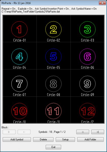

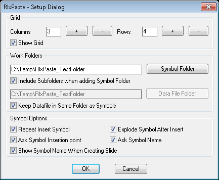

rlx Posted January 3, 2016 Posted January 3, 2016 (edited) First of all happy new year for everybody. Now about this app , RlxPaste. I often have need to copy some objects from one dwg to another. Although I allready have written a 'perfect' app for that , all my colleagues use it and I didn't want to add my junk symbols to it. So I came up with this app , which allows you to simply create symbols on the fly for local use. I think / hope the interface is self explanatory. You can control the grid in the setup dialog and you can select the folder where you save your symbols. Btw , double click to insert and if you want to delete item , click delete button and then click on image to delete. You can add a complete folder and its subfolders at once with the button Add Folder in the main dialog. This is usefull when you have for example a cd from a vendor or client with their company symbols. Hope it is usefull. gr. Rlx RlxPaste.dclFetching info... RlxPaste.LSPFetching info... Edited January 14, 2016 by rlx 2 Quote

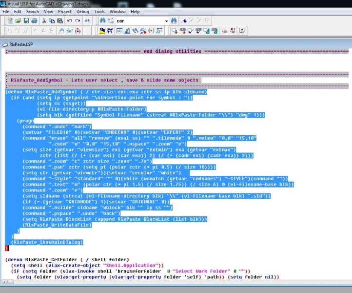

rlx Posted January 4, 2016 Author Posted January 4, 2016 Hi Grrr, looks like something is going wrong in read-datafile (defun RlxPaste_ReadDataFile ( / fp inp) (setq RlxPaste-DataFileName (strcat (getvar "SAVEFILEPATH") "RlxPaste.dat")) (if (not (findfile RlxPaste-DataFileName)) (progn (setq fp (open RlxPaste-DataFileName "w"))(close fp)(gc))) (if (setq fp (open RlxPaste-DataFileName "r")) (while (setq inp (read-line fp)) (if (findfile inp)(setq RlxPaste-BlockList (cons inp RlxPaste-BlockList))))) (if fp (close fp))(if RlxPaste-BlockList (setq RlxPaste-BlockList (reverse RlxPaste-BlockList)))) I use savefilepath (in my case here at home this contains "C:\Users\Rob\appdata\local\temp\") and this usually is a folder where every cad user has read/write acces. Never had any problem with this. But you could try another folder for the data file , something like : (setq RlxPaste-DataFileName "c:/temp/RlxPaste.dat") Dont know if you know you to debug a program by setting breakpoints. Place your cursor at beginning to a line of code and press F9 and you should see a red marker , indicating the program will wait there so you can inspect variables. I don't see anything wrong with my code so I think it has to do with write acces. But if savefilepath proves to be not fool proof I will maybe have use another strategy. Gr. Rlx Quote

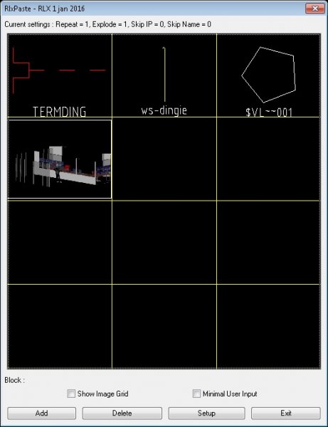

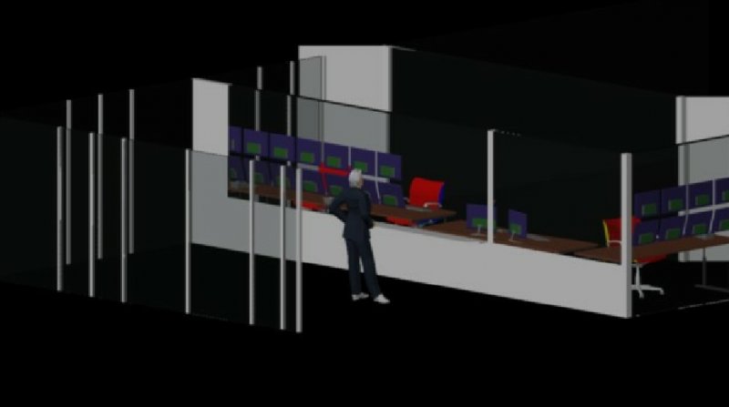

halam Posted January 4, 2016 Posted January 4, 2016 It works so far. Was wondering if you could get previews better as 3D shaded.. little challange Quote
rlx Posted January 5, 2016 Author Posted January 5, 2016 (edited) halam said: It works so far. Was wondering if you could get previews better as 3D shaded.. little challange now that would be a little challange indeed :-) Could play with background color of dialog slide image , could try to first save 3d shade as image , attach it and make slide from that. Never ment this app for complicated / shaded objects , but you're right , it would be a challange gr.Rlx Edited January 5, 2016 by rlx Quote
Grrr Posted January 6, 2016 Posted January 6, 2016 Hello Rlx, sorry for late replying: I can comfirm that it works on acad 2015 ! But I still have another problem - I don't get that alert box like in the video for "Confirm Export of Autocad Map Data" And the main issue after that is that all my lines/plines in the entire drawing turn bold like in your preview boxes. Do you know what might be the problem? Command: RLXPASTE Insertion point for symbol : Select objects: Specify opposite corner: 14 found Select objects: .undo Current settings: Auto = On, Control = All, Combine = No, Layer = Yes Enter the number of operations to undo or [Auto/Control/BEgin/End/Mark/Back] <1>: mark Command: Mark encountered Regenerating model. My guess is somewhere here: Quote
rlx Posted January 6, 2016 Author Posted January 6, 2016 Hi Grrr, Since I don't work with Autocad 2015 I can't really duplicate your problem. What I can do is to try to use another way to save the blocks and make the slide. The way I do it at the moment is a kinda dragon-approach : set undo mark , then select your objects , 'kill' the rest (erase) , zoom in on them & make a slide. Guess I could try to be more 'gentle'. The reason it works (and was ment) for me is that I work with just plain 2d electrical diagrams , so small drawings , no need for usc , ocs , trans etc etc. Did make some changes to the app allready but I wil have another look at slide making process as soon I have time to do so. The app is in fact more or less a fancy copy / copy with base point , no more , no less. gr.Rlx Quote

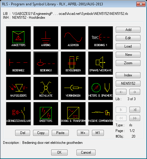

little_stone Posted January 8, 2016 Posted January 8, 2016 Great job! But how to page up and page down? Quote
rlx Posted January 8, 2016 Author Posted January 8, 2016 little_stone said: Great job! But how to page up and page down? You don't ... You can increase the grid but that's it. This routine is just ment as an example and as a copy paste (hense the name). I have another app for my symbols which has a ton more options , but its vanilla and as it is right now not as stable as I would want it for me to publish something like that on the web btw , welcome to Cad Tutor! Gr.Rlx Quote
