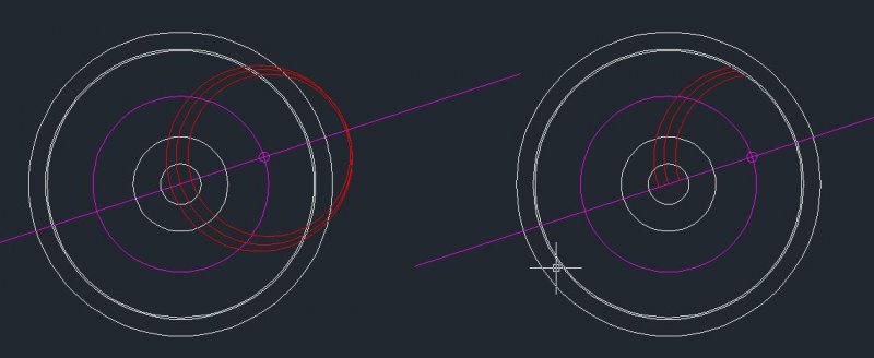

ortizwk Posted January 1, 2016 Share Posted January 1, 2016 Hi everyone I'm starting to draw in autocad, and i've been trying to make a rim, but i have a problem i don't know how to make the width of the rim, first i did an arc of 3 points from the first circle to de second and connect to the last circle, and after that i did an offset of 1.5 and 2 becase the arc that connects with the angle of 30° is supposed to be 26, so and offset of 1.5 should give me 27.5 and an offset of 2 to the right should give me 24 but, anyway i don't think i'm correct or if the arc command is the correct one to use. I'll attach an image of the diagram, i hope you can help me. thank you very much. I'm using autocad 2014 NO LT Quote Link to comment Share on other sites More sharing options...
BIGAL Posted January 2, 2016 Share Posted January 2, 2016 Look at 18deg line using hub centre pt draw a circle 26 radius then using this crossing pt draw a circle 1.5 radius this give correct cen pt for the arms again draw circles and trim. Hopefully this image helps. Quote Link to comment Share on other sites More sharing options...
ortizwk Posted January 2, 2016 Author Share Posted January 2, 2016 thank you very much that was exactly what i needed to do i was doing it all wrong, you save me. thanks again friend! Quote Link to comment Share on other sites More sharing options...
