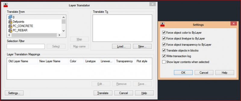

Ibanezboy21 Posted December 22, 2015 Share Posted December 22, 2015 (edited) Hi all I'm trying to create a script to change layer A to layer B and match layer B's properties What command should i use in the script? thanks :edit i think i have to use the matchprop command but I'm not sure how to write it out Edited December 22, 2015 by Ibanezboy21 Quote Link to comment Share on other sites More sharing options...

RobDraw Posted December 22, 2015 Share Posted December 22, 2015 No script needed. Layer Merge does exactly what you want. Quote Link to comment Share on other sites More sharing options...
Ibanezboy21 Posted December 22, 2015 Author Share Posted December 22, 2015 No script needed. Layer Merge does exactly what you want. Hi Rob, What do you mean its not needed? I'm trying to find a way to change all the layers from a drawing from another office into our layers. I could change each layer one by one to match ours or I could make a script that does it automatically. I'm just trying to figure out the command to get it started Quote Link to comment Share on other sites More sharing options...
RobDraw Posted December 23, 2015 Share Posted December 23, 2015 You only mentioned one layer to another. Layer Translator will do what you've stated so far. Quote Link to comment Share on other sites More sharing options...
Dadgad Posted December 23, 2015 Share Posted December 23, 2015 You only mentioned one layer to another. Layer Translator will do what you've stated so far. +1 Layer Translate (laytrans) is definitely the way to go. If you anticipate working with this vendor again, save your mapping template, for the next time you want to do this. Quote Link to comment Share on other sites More sharing options...
