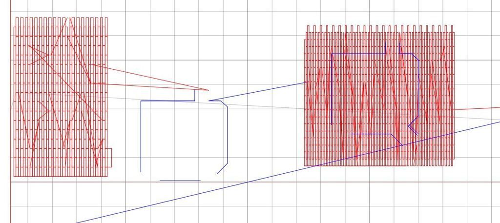

Jeff K Posted December 19, 2015 Posted December 19, 2015 I just started using 2015 when I draw I get lines I didn't draw. It looks like trails from a copy command? I've never had this happen on my 2010 version. i've read about mouse trails and graphic card issues. I hope that isn't the problem. Quote
RobDraw Posted December 19, 2015 Posted December 19, 2015 Are they persistent or do they go away? Quote
Jeff K Posted December 20, 2015 Author Posted December 20, 2015 They will disappear when I zoom "just right". Or if I change my "visual styles controls" away from 2D Quote

Tyomex Posted December 20, 2015 Posted December 20, 2015 Maybe this is solution: https://knowledge.autodesk.com/support/autocad/troubleshooting/caas/sfdcarticles/sfdcarticles/Unwanted-linework-appears-when-opening-drawings-in-AutoCAD-2015.html Quote

Jeff K Posted December 20, 2015 Author Posted December 20, 2015 It only happens when I do multiple copy and paste. I deleted the grid I drew and the mystery lines went away, I copied them back in one by one and it was fine. Quote

TheCADnoob Posted December 21, 2015 Posted December 21, 2015 I had this same problem and it was the graphics acceleration (solved by the post linked earlier). Another temp way around it is switching from a '2dwireframe' to a 'wireframe' view. Quote
Jeff K Posted December 22, 2015 Author Posted December 22, 2015 I had this same problem and it was the graphics acceleration (solved by the post linked earlier). Another temp way around it is switching from a '2dwireframe' to a 'wireframe' view. There it is! that solved it! I tried other views but not that one. Thanks. Quote
