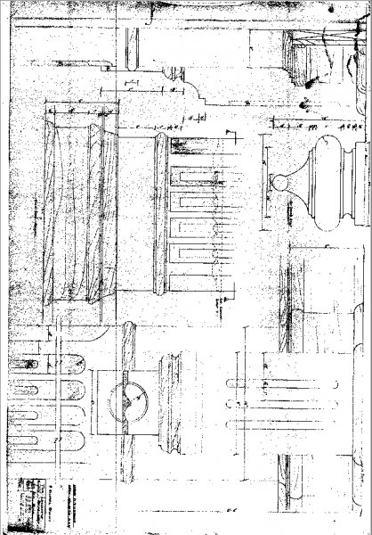

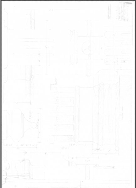

squareknees Posted December 18, 2015 Posted December 18, 2015 I inserted the same object 2 different ways and I get 2 VERY different results. The first image is an Xreference of a PDF and this is how it turns out. the second image is when I copy the image from the PDF and paste it into AutoCAD. I got this PDF and it is really light and I need to take dimensions off of it. when I try to create a PDF the top image ends up lighter then seen here and the bottom image ends up black or white with no details at all. HELP! I have already spent too much time on this I just need it to print out dark enough to be able to read it! Quote

squareknees Posted December 18, 2015 Author Posted December 18, 2015 that is part of the problem I don't have another program to get the contrast. I have tried PDF editors online and downloaded (company won't pay for Adobe Acrobat) I created these with Print screen and Microsoft Paint. I would use Microsoft Paint to clean it up but I still need to print to a PDF and I can't get the resolution I need to be able to take dimensions off of it and then print so I can show my co-workers that 'this what the trim looks like and this is the sizes of the trim' Quote
TheCADnoob Posted December 18, 2015 Posted December 18, 2015 Gimp is free though there is a little bit of a learning curve if you are not used to that level of graphic editing software. https://www.gimp.org/ I frequently have to recover old sepias and various other garbage duplication formats which have faded horribly over the years. I use gimp. I switched to gimp from Photoshop for the price tag. If you load the original i can see if i can help. Quote
