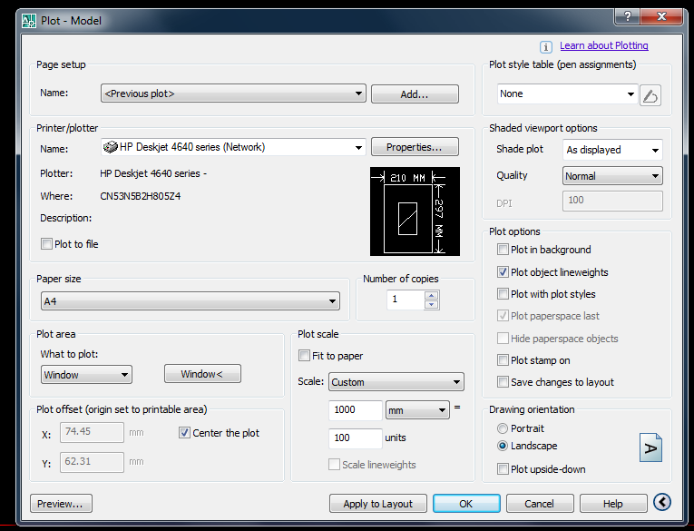

freeriding Posted December 16, 2015 Share Posted December 16, 2015 Hallo guys! I had never such a problem with cad 2008. Simply put, i draw a rectangle 100x50 and set a plot scale eg. 1:1 and in the plotted paper it is smaller eg.91x45. The same happens in every plot scale i use. I have an A4 hp 4645 printer, but the same happens also in pdf export (freepdf). I never had this problem again!!! Why is that, and how can i fix it? Quote Link to comment Share on other sites More sharing options...

eldon Posted December 17, 2015 Share Posted December 17, 2015 I have tried plotting your drawing and get perfect results on the scaling. Perhaps the operating system may have altered and maybe the printer driver needs to be updated. Usually, the thumbnail sketch showing the orientation, is the proper way up, but that may be an HP peculiarity. Quote Link to comment Share on other sites More sharing options...
nukecad Posted December 17, 2015 Share Posted December 17, 2015 I think eldon's image may have given the clue here. I know you said you plot from modelspace but try selecting the 'Save Changes to layout' button. If this is not selected than changes made in the plot dialogue can be ignored when it comes to plot. Quote Link to comment Share on other sites More sharing options...

eldon Posted December 17, 2015 Share Posted December 17, 2015 I think that a template is irrelevant in this case. If the OP were plotting from Paper Space, then the template is relevant. The units seem to change to metric and imperial all depending on what paper size is chosen. I plotted by window, and picked the corners of the red square as my window. Quote Link to comment Share on other sites More sharing options...

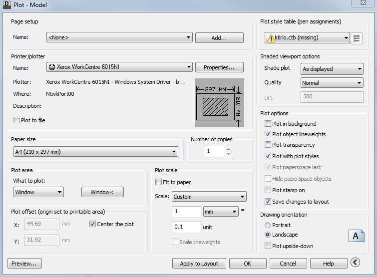

freeriding Posted December 17, 2015 Author Share Posted December 17, 2015 problem solved. i uninstalled and installed again the printer. thank you all! Quote Link to comment Share on other sites More sharing options...
