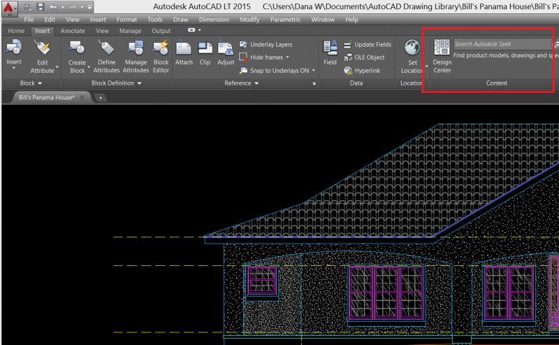

Hi All
I remember in the full version there was a feature called design centre (i think) where i could pull off the linetypes, blocks, textstyles etc. and transfer them to other drawings
can you do it in LT?
Yes, the command is "adcenter" (adcclose to close it), or the Ctrl+2 key combination
