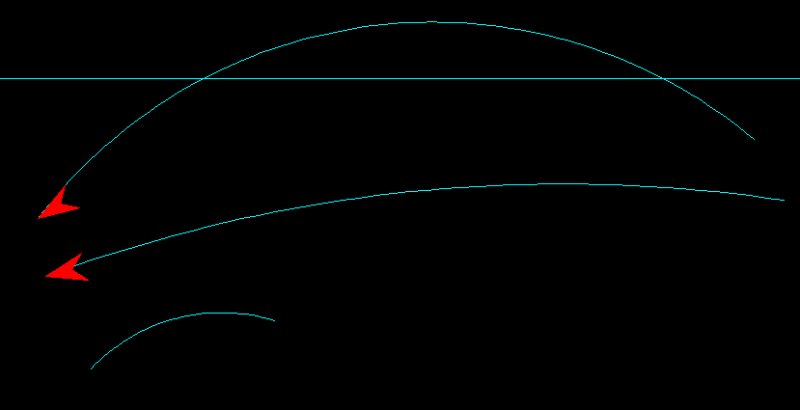

I have an Arc Leader lisp that I have modified to use my company's arrowhead, changed the command to scale to dimscale but I am missing something about the arrowhead placement and the allowable size of the arc which the arrowhead can be placed on. I have attached the lisp command that I have modified so far, the arrowhead I want to use, which is the correct size and scales great. I have also added a few pictures, One of my command line when the arc leader is too small to attach the arrowhead. And the corresponding arc in the model. Also a picture of multiple arcs created showing that the arrowhead is not rotating when placed to be aligned with the arc.

Lee Mac's Lisp routine is great but it does not let you specify the arrow head only the length and width. I need the arrow head to be the same block that my company currently uses.
Please try the following:

The above should also perform successfully under all UCS & View settings.
Lee,
That works great, but it seems the arcleader is set to come in on current leader. where is the line that specifies to come in on the current leader? I want to specify a specific layer to draw the arc leader on.

never mind, I figured out how to change the layer. I added at "setvar" statement to the beginning of the program.
