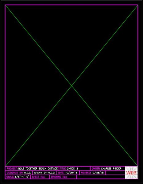

welldriller Posted December 11, 2015 Posted December 11, 2015 I have never used a border on drawings before but wanted one for this drasing. i made the border in a 1 inch square and made a block out of it so that i could fit it around any size drawing. The problem is i only have a 81/2" x 11inch printer. When i had it enlarged at a print shop the border to me is way to big. Any suggestions on how to correct this? (no i can not afford a plotter) Sorry do not have copy of drawing with me today --- will try again next time thought i could delete this but forgot how. Quote

ReMark Posted December 14, 2015 Posted December 14, 2015 (edited) I think the idea of a 1x1 block for a title block and border is not a good way to go. Create a new template based on a 8.5x11 piece of paper. Personally, I think your border is a bit too busy (ex. - you don't need the letters & numbers on the perimeter) for the type of drawing you are doing. You call out the scale in your title block and border as 12"=1'. That is not a typical architectural scale for a floor plan done in imperial units. Depending on the size of the building most are either 1/8"=1'-0" or 1/4"=1'-0". When you insert your block into a 8.5x11 format what scale are you assigning to X and Y? Obviously not the same scale. BTW...wouldn't your design be considered a prefabricated house? Additionally, wouldn't the exterior walls be more than 4" thick? If you are using 2x4 construction with 1/2" wallboard on the interior face what is being used for the exterior sheathing? It can't be just Tyvek. Why are you showing a 42" wide entrance door? Is there a sidelite? Isn't 36" the norm? Edited December 15, 2015 by ReMark Quote

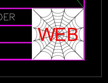

ReMark Posted December 15, 2015 Posted December 15, 2015 No reply? Guess I'm left to my own devices then. Here is something to ponder. I'm assuming that when you insert your block you leave a small amount of free space between the edge of the paper and your border. What you end up with then is something like this. Notice the size of the area (green cross) left for displaying your drawing. Now if we were to rework your whole title block and border to something along these lines notice the size of the area available for displaying your drawing. The distance between the edge of paper and the border is exactly the same as when I used your block. BTW...most people use initials and not full names in their title blocks. And for a drawing that is this small I would forego the use of a revision block. Oops. I see I forgot to put Drawn By: on the proper layer. My bad. Here is a closeup view of the logo I came up with. Quote

welldriller Posted December 18, 2015 Author Posted December 18, 2015 ReMark said: No reply? Guess I'm left to my own devices then. Here is something to ponder. I'm assuming that when you insert your block you leave a small amount of free space between the edge of the paper and your border. What you end up with then is something like this. Notice the size of the area (green cross) left for displaying your drawing. [ATTACH]56388[/ATTACH] Now if we were to rework your whole title block and border to something along these lines notice the size of the area available for displaying your drawing. The distance between the edge of paper and the border is exactly the same as when I used your block. [ATTACH]56389[/ATTACH] BTW...most people use initials and not full names in their title blocks. And for a drawing that is this small I would forego the use of a revision block. Oops. I see I forgot to put Drawn By: on the proper layer. My bad. Here is a closeup view of the logo I came up with. [ATTACH]56390[/ATTACH] i very much like your idea. i do not understand how to make a border for 81/2" X 11" paper and put a drawing inside it that is say 80 foot long and 65 foot tall. Guess i will have to work on that. Quote
ReMark Posted December 18, 2015 Posted December 18, 2015 Your profile says you are located in Kentucky. Last time I checked that state was still a part of the United States. Units are either imperial (what we use in the U.S.) or metric what the other 99% of the world uses. What are English units? To get an 80 foot long building on a 8.5x11 piece of paper you can draw it full size in model space then elect to scale it down when it comes time to print or you can make use of a paper space layout and at least one viewport. It is the viewport that the scale would be assigned to. We don't draw "to scale" as one might do on a drafting board. A viewport is just a window that allows the user to see what they have created back in model space. When it comes time to print from a layout you do so at a 1:1 scale; AutoCAD will handle scaling what is in the viewport automatically. Quote
