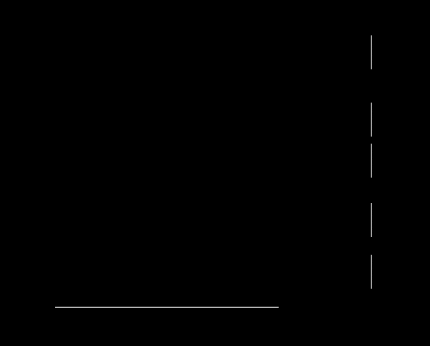

Hi all, good day.
I have this script below which copies along the x and y axis with two separate commands. CX and CY.
2 issues.
  1. I need it to regen every time I copy (There's a bug when I copy leaders at the moment) (command ".regen") has no effect.
  2. Copy multiple, After first copy the restraint no longer take effect.
Thanks for any help.

When using the _Multiple option of the _Copy command you obviously cannot rely on a fixed number of arguments for the command function.
(defun c:test ( / ss)
 (setq ss (ssget))
 (command "._copy" ss "" "_multiple" pause)
 (while (/= 0 (getvar 'cmdactive))
   (command ".yz" "@" pause)
why not use the copy command normally with ortho mode on?
Because see this. I have so many uses for it. Try snapping perpendicular to a point in x or y.
Why did AD add-in a point filters for x, y & z if they didn't want us to use it?
 (setq ss (ssget))
This worked absolutly perfect. Thank you. Neat trick with the while. I'll keep this in mind.
