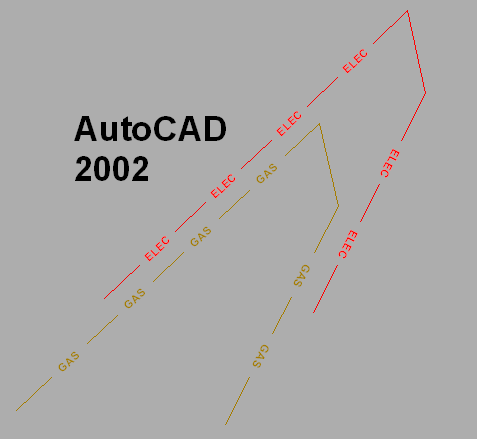

SAFeSTeR Posted December 3, 2015 Posted December 3, 2015 I'm using a couple of custom linetypes which I created and one is reading logically (ELEC) but when I changed to another linetype (GAS) the text reads as it follows the direction of the polyline. I didn't expect it to read logically but it looks better on the drawing. I created both linetypes and followed similar formatting (see below) so I've no idea why this is happening. Does anyone know how to achieve this purposely so all read logically? *ELECTRIC,Electric Cables -- ELEC ---- ELEC ---- ELEC -- A,0.5,-0.3,["ELEC",Text - Arial,s=0.1,r=0,x=-0.175,y=-0.05],-0.3 *GAS,Gas Pipes -- GAS ---- GAS ---- GAS -- A,0.5,-0.3,["GAS",Text - Arial,s=0.1,r=0,x=-0.15,y=-0.05],-0.3 Quote
dbroada Posted December 3, 2015 Posted December 3, 2015 are you sure both polylines were drawn in the same direction? There is a command (the name of which I have forgotten) that will reverse the direction of a polyline. Quote
eldon Posted December 3, 2015 Posted December 3, 2015 Have you tried to use "U=0" instead of "r=0" in the linetype definition? Quote
BIGAL Posted December 4, 2015 Posted December 4, 2015 When a pline is made up of a lot of joined lines you can have two directions in one pline, fix by exploding flip 1st line etc to correct direction and rejoin. This fixes arc problems. Dbroada PE pick pl "R" Quote
eldon Posted December 4, 2015 Posted December 4, 2015 Not being able to see your attached picture (if any??), but based on Bigal's remark, have you checked that Pline generation is enabled? Quote
SAFeSTeR Posted December 4, 2015 Author Posted December 4, 2015 are you sure both polylines were drawn in the same direction? ...have you checked that Pline generation is enabled? Maybe I should have said, the polylines in my examples are actually the same one, I just changed the linetype and this is how I discovered the issue. It must have to be something in the linetype definition rather than the polyline itself? Have you tried to use "U=0" instead of "r=0" in the linetype definition?I will try, but would this make a difference as both linetype definitions use "r=0". When a pline is made up of a lot of joined lines you can have two directions in one pline, fix by exploding flip 1st line etc to correct direction and rejoin. This fixes arc problems. I wasn't aware of that, but like I already said, the polyline is in fact the same one so this shouldn't occur. I will experiment with this technique when I have some time. Anyway, thanks for all the replies and suggestions, the designer has decided he doesn't want utilities shown in the drawing now as they are not guaranteed to be accurate, so there is no issue now. Quote

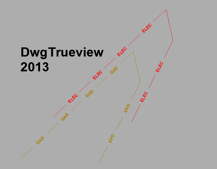

eldon Posted December 4, 2015 Posted December 4, 2015 The easiest way to get a definitive answer would be to post a drawing containing only that polyline and with both linetypes loaded. Otherwise we are peering into a crystal ball, and giving you more work to try out our suggestions. The "U" factor gives Upright text. The "r" factor only gives a rotation relative to the line, and if the line is going the other way, then the text is the other way. Why it should change with different linetypes might be revealed by letting others work with your drawing. Quote
SAFeSTeR Posted December 4, 2015 Author Posted December 4, 2015 Like I said, I'm not that bothered now as it is not required in the drawing any longer, however, I have replicated the situation for you to look at if you want. Strangely, the first time I trimmed the drawing down, both linetypes behaved the same, reading in the direction of the pline as in the 'gas' example, the same thing happened when I copied the portion of the drawing into a new drawing. The attached drawing was my 3rd attempt and it left here as intended, maybe it will behave differently when someone else opens it? LinetypeOrientation.dwg Quote
eldon Posted December 4, 2015 Posted December 4, 2015 Thank you for taking the trouble to post a drawing. Unfortunately, the problem is one of those quirks in AutoCAD which defy explanation. I converted the drawing to r2000, and opened it in my AutoCAD 2002, and then opened the same drawing in DwgTrueview 2013, with the results below. I think the way forward is to try the "U" factor in the linetype definition and see how that goes. Unfortunately, I cannot do that myself, because the "U" factor is too modern for me. Quote
SAFeSTeR Posted December 4, 2015 Author Posted December 4, 2015 I did actually begin to type in my previous post that maybe it's one of those quirky things but removed it before posting. Oh well, I will do some experimenting when I'm not so busy and will post my results if I find anything conclusive. Thanks all once again. Quote
eldon Posted December 4, 2015 Posted December 4, 2015 It should be pointed out that both Polylines had the Linetype generation disabled. It has been noticed in other threads, that this allows some elements of the line to "run" the other way. In this case, if the Linetype generation is enabled, then some of the placement of the text is inconvenient. Quote

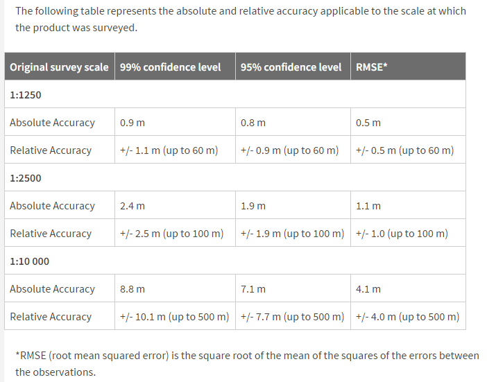

eldon Posted December 7, 2015 Posted December 7, 2015 The main problem is that the base map used is the Ordnance survey mapping, which is like the curate's egg - good in parts. The OS mapping has a policy of generalisation, so not all feature lines are shown. The attached picture of an accuracy table is snipped from the Ordnance Survey web-site Quote
SAFeSTeR Posted December 7, 2015 Author Posted December 7, 2015 Yes, I forgot about the level of accuracy of the OS maps. However, I do think that when digging down on utilities the lack of accuracy is somewhat minimised due to the size of the holes they dig. Quote
