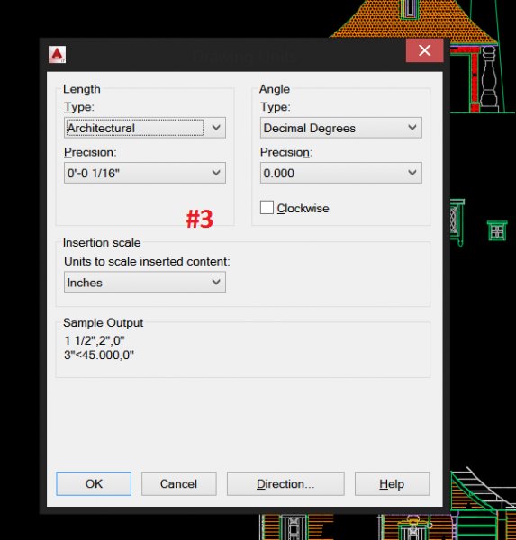

I cant figure out how to remove decimals?
In dimensions gives correct w/o any, but ie if draw pline it has 3 decimals. I using metric measures and dont need accuracy 1/1000 of a millimeter. How can I round those away?

Change the following precision levels, in the Dimension Style Manager, and the UNITS command. Image #3 shows the UNITS dialog box.

The UNITS command controls the precision level of what shows by your cursor while you draw, and what shows when you use the measure set of commands to get a Distance Measurement.
You can also suppress leading and/or trailing zeros using the dimension style editor.

Great tnx.
I didnt have similar screens as running a architechtural addon on over the acad. units command did the trick. This addon heavyly modifies the way acad works.
But now can atleast get to one millimeter precicion and not parts of it :) Cant exactly give ie carperter 0.001 mm tolerance on cutting wood :)
