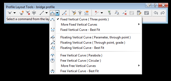

Perhaps I didn't explain myself clearly. I am looking to do a short demo of the different types of vertical curves available when designing a profile in civil 3d. There are about 14 different types and I was looking for a resource prior to having to write it all out.

I am doing a terrible job explaining what I am looking for in this thread. I am looking for explanations, applications and descriptions of the curve types listed in the dialog box shown below.
I understood your meaning just fine; see the last segment of my previous post. :thumbsup:
