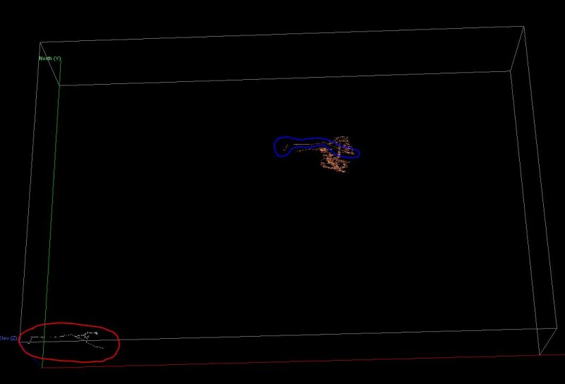

Although I think it only partially worked. It seems like the "spatial reference" of my model is gone in the process. See attachment Position.jpg. The blue circle is where the mining complex really is and the red circle is where my test sample is after the whole process. I'm not sure how to fix that :(

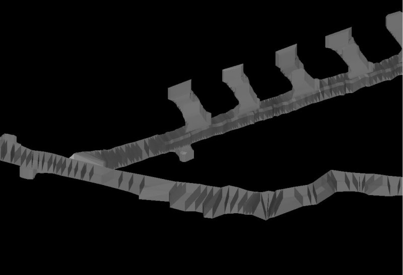

I'm pretty sure that the co-planar faces are gone but I still have walls from the original faces in my tunnel. See Walls.jpg (from a tilted dropdown view). What I ultimately need to do is to find a way to remove all the darker grey rectangle-like faces in my tunnel so it could be empty. As you can see, I have many of them and this is just from a small sample. That's why I was thinking about going with some kind of outer shell around the tunnel while ignoring everything that is inside.
I do not know why the geometry is repositioned. Can you fix this by noting a before and after point to determine how much to move the repositioned geometry?
Can you post a small sample of the file? I would like to see if there is some distinguishing property of the "darker grey walls" from the tunnel side walls.
Yeah I could find the exact coordinates of a specific point in the mining complex and try to move the processed model to that point. There's probably a tool that could assist me in that right ?

I have classified the faces into 2 categories, the barrier walls (B-walls) and side walls (S-walls). The B-walls contain the faces you want to get rid of. I could find no property that I could easily identify with a program. So, I think the approach you may need to take is one of process. I used the following process with some success. Remember that a select widow that goes from left to right selects only those objects that are completely within the window whereas a select window the goes from right to left selects objects within and that cross the window.
Note, the file you posted had double faces. It looks like a copy of the model was made directly on top of the original. If this is the case for your master file you may want to look into a routine that deletes duplicate geometry as a start.
Here's the process I used.
I defined two additional layers Barrier-walls (yellow) and Side-Walls (magenta). I then froze the SIde-Wall layer. Using Free Orbit I rotated the view such that I had a top view but the tunnel I wanted to edit was close to being horizontal or vertical. I then did a select window (left-right) that encompassed a bunch of side walls but never a full barrier wall. I then changed the layer of the selection to the frozen Side-Wall layer. Once I hid the side-wall I could easily change the layer of the Barrier Walls.
In this image you can see a select window that selects several hundred faces of the side wall without selecting and barrier walls.
Here's an image that shows a portion of the tunnel with the barrier walls isolated to a separate layer.
The process is a bit painstaking but not impossible. Perhaps someone has a better way.
