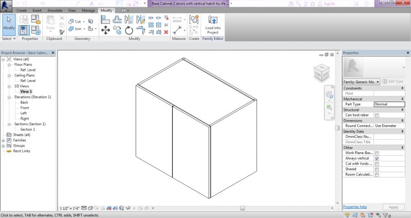

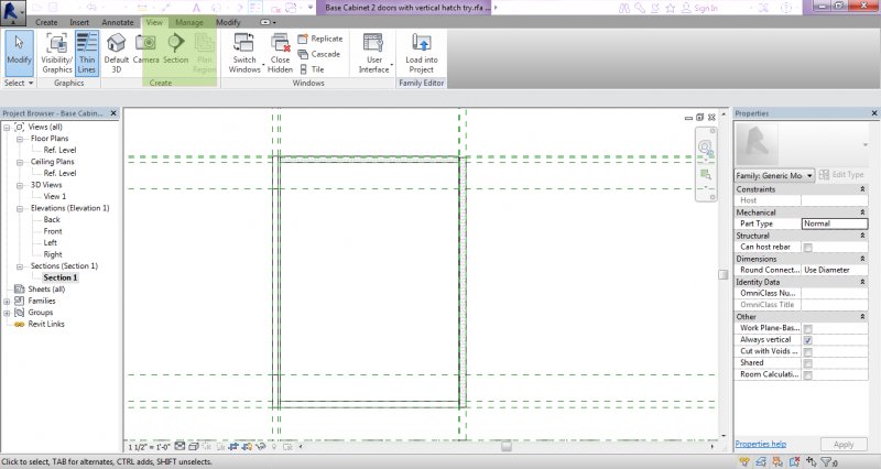

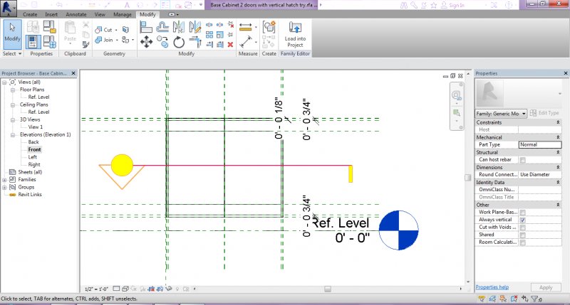

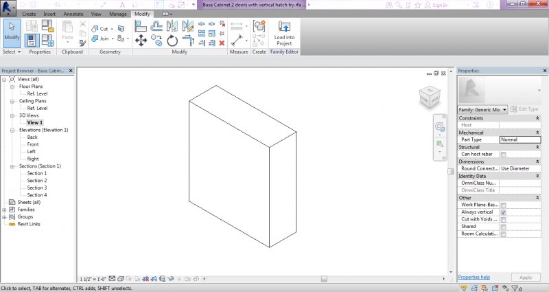

gmarkov1 Posted November 29, 2015 Author Posted November 29, 2015 OK. Sory for the confusion. I will try to explain it thoroughly: 1. I created a Base cabinet Family (see picture: 3D View) - Parameters applied. Everything works fine. 2. I started applying Materials and Finishes. I added Parameter accordingly. Then I opened Material Browser > Graphics > Cut Pattern (I am interested in it only. Both Shading and Surface Pattern I left without attention because they are not part of my work). 3. The first part I applied a Cut Pattern to was the cabinet back. 4. I wasn't sure what the visual effect would be so I placed a Section (View>Section) -see picture: Vertical Section. That Section (see the rectangle under View Tab) was with only one purpose: just for me to see how Cut Pattern looked like i.e. for verification purposes only. Once I saw that everything was fine I deleted that Section View. 5. (In millwork drawing that view is called Vertical Section) 6. Then I started applying the same Cut Patterns into base cabinet sides and doors. 7. Once again I was curious how those Cut Patterns looked like. So, in order to be able to see it, a horizontal cutting plane needed to be placed i.e. to cut that base cabinet through a certain point (see picture: Elevation with a reference). For verification purposes only. 8. (In millwork drawing standards this is called Plan Section or Horizontal Section). 9. I was not able to find a way to place (just temporarily, for checking purposes only) such horizontal section. 10. Then I decided to load that Family into a Project, to create a level through that base cabinet hoping that then I would be able to see the Cut Pattern (through sides and doors). Unfortunately I did not see anything. 11. Now, my confusion, based probably on the AutoCAD logic: When you draw a 2D shape, you are always able to hatch it (Pattern it in Revit), most commonly in Top View. So, the client may see Vertical Sections, Horizontal (Plan) Sections wherever it is necessary. For Example, if you have a Kitchen, one Plan Section will be through base cabinets and second one through wall (upper) cabinets. So, the client will have all the information needed via those two horizontal sections. - In AutoCAD everything has to be drawn manually i.e. a chance of mismatching (a drafting error) between different views is significant. In Revit, I assume (if I am not mistaken), that process can be made straightforward, annulling any chance of mismatching. That's why I am trying to apply those casework drawing into Revit instead of AutoCAD. Thank you immensely for your time and kindness of helping me. Regards and Respect. Quote
tzframpton Posted November 29, 2015 Posted November 29, 2015 Upon a very quick assessment, here's what I came up with. Click the two images below for the full resolution. http://i.imgur.com/yXkKCTg.png http://i.imgur.com/95DzRGF.png In the first image, I couldn't get the View Range to "cut" through the Casework Family. So what I did was in the Section View, I created a Section (which only let's you place one vertically) and I rotated the Section 90° to face down. This worked. I can see the cut pattern, which makes sense because it's a section cut, not a View Range cut in a Plan View. So, I'm going to assume, until proven otherwise, that this is the only way to achieve what you're after, which is fine actually. I'm guess Revit, for a good reason I'm assuming, does not want the Plan View to truly "cut" through casework since it's very rare that Architects will want this to truly "cut". But some like yourself, you in fact do want this. So go this route for your plan views. Second image, I realized the Casework Family has one additional function in the Visibility Settings (highlighted in red). I thought this would surely "cut" in Plan View, but I think it's more of a partial cut, not a full cut. I'm not sure. This is interesting though, and you may be able to find the casework can in fact be cut via the View Range. So, that's what I came up with. Hope this helps you some. At least, with Section Views rotated, you can certainly get things rolling the way you need. -TZ Quote

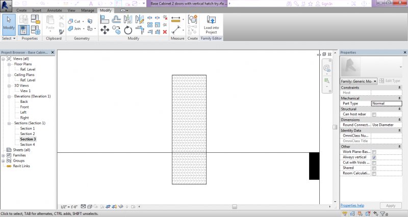

gmarkov1 Posted November 30, 2015 Author Posted November 30, 2015 Sir, thanks a lot once again. Actually I found the same solution (as your first one) but I had been thinking that there should be another (more user-friendly) option. IMHO, it is so short-sighted for creating such a complex software and stopping short of making it perfect. But... One more, I hope final, question concerning my fight with Revit: Is there a chance to rotate those cut patterns i.e. to place them correctly. Attached are pictures with plywood pattern because it is so common in casework drawings: As you can see, the Pattern is not aligned correctly, I mean that picture 1.1 (Vertical Section) is not correct (If I give another example with Auto CAD, the Hatch angle would be 90 degrees). So, I tried all options into Cut Pattern > Edit > Orientation in Host Layers. I also searched into the web but nothing... I think that those Cut Patterns will be the only (but significant one) hurdle towards implementing my skills from AutoCAD to Revit. Thanks once again. And once again I truly rely on your advices. Quote
