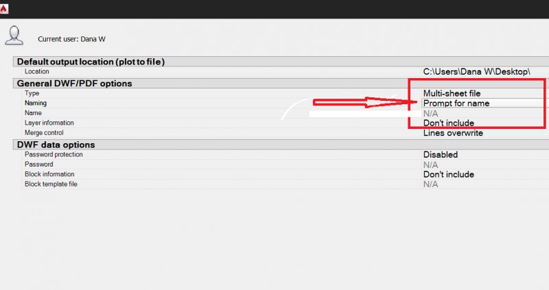

Does your publish options say Prompt for Name, or Specify Name? If it says Specify Name, then change it to Prompt for Name. Then, it will show you what it wants to name the output file, and if you like it, you don't have to change it. The drawing file name.pdf is the default. It's usually good enough for me.
