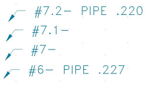

tmelancon Posted November 18, 2015 Author Share Posted November 18, 2015 Lee, I am just noticing I have another issue. I completely forgot there are times where we have multiple data labels within one label (i.e. #50.1, #50.2, #50.3). When I enter #50.1 it doesn't come in as #50.1, it comes in as 50, it is leaving out decimals altogether and rounding. I forgot to mention that when I started this thread and shouldn't have posted the title as "Remove Decimals", that was misleading. The real goal was just to remove the ".00" only when they have no data that exist in the .DAT file when it goes and searches. However when there is in fact data, I need it to insert for example #16.1- or #16.2- but at the same time display #50.1- not #50.10 or #50.00 if there isnt any data built in yet for #50.1- but we still want to show the call out for when we do inspect and insert data for that label. I hope this helps and I appreciate your time helping me with this. Quote Link to comment Share on other sites More sharing options...
tmelancon Posted November 18, 2015 Author Share Posted November 18, 2015 So in one drawing we may have: #17- PIPE .290 ;; currently built in and has data in the .DAT file #17.1 - PIPE .220 ;; currently built in and has decimal because its a second data reading within the same location #50.10- ;; this label has no data and this is what was displayed before we made the change #50- ;; this label was entered as 50.1 after the change but appears to be rounding. I still need it to display the decimal and number in the tenths column. My apologies for the misleading original post. Again I just need some sort of exception, because the change is all really for the data labels that have no data because we dont like seeing ".00-0.00" or ".00". I would like for the original code to be run as normal on all other data labels that exist in the .DAT file and have data. Quote Link to comment Share on other sites More sharing options...
tmelancon Posted November 18, 2015 Author Share Posted November 18, 2015 Here is a picture of what I am talking about. The bottom data label #6 is a whole number and has data. Then, label #7 is a whole number without data in the .DAT file. Next is label #7.1 which is a real number with no data. Finally there is label #7.2 which is a real number with data. This is how I need them to display. Regardless of data existing or not we dont like seeing 0.00's and .00's or .00-0.00's all over our drawing when we have dozens of labels called out but havent yet been inspected. Quote Link to comment Share on other sites More sharing options...
