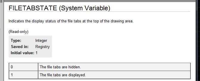

I forgoet what those drawing tabs are called, I think they were new in 2016, I use 2013. Somebody will help you with them. If it were me, I would probably turn them off, as they eat up a lot of screen real estate.
Don't LOAD your .dwt file.
Start a NEW drawing, and when asked from which template, pick your chosen .dwt.
That is DIFFERENT than OPENING your .dwt.
The system variable for enabling/disabling File Tabs is called FILETABSTATE.
From the looks of the image you attached you failed to save your drawing under a unique name so AutoCAD defaulted to Drawing1.dwg. The proper procedure after having created a custom template file is to start a new drawing with the template then do a "Save As" and give your drawing a new/unique name. You did not do that. Just out of curiosity what is the name of your custom template file?
Edited by ReMark
The tabs above are showing separate files, so you haven't done anything wrong and you don't have that as part of your .dwt file. If it really bothers you change STARTUP to 2. Close AutoCAD and reopen, pick a file to open from the startup screen, you won't have the extra Drawing1 file showing.
