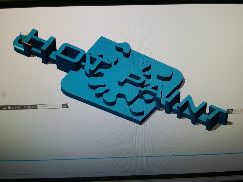

amcutem Posted November 11, 2015 Posted November 11, 2015 Hi guys, can someone help me figure out why after I explode my text, it changes size and moves away from where I had it placed? It also gets a lot bigger after I explode it and I have to scale it down to fit? Any clues? Thanks Quote

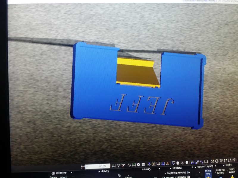

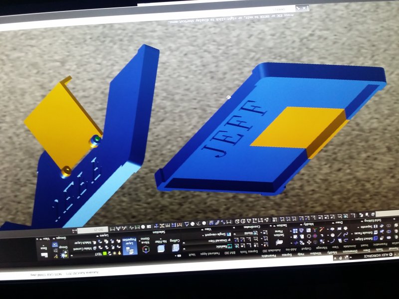

amcutem Posted November 11, 2015 Author Posted November 11, 2015 Im exploding the text because i want to turn it into an object so that i can subtract and cut through or extrude the text for using it on keychains that I 3D print for friends and anything I want to have a text on. Im I not doing it the proper way? For some reason, I can grasp most of the context about CAD, but my brain smokes when It comes to knowing the difference between annotative and standard? I think im gonna read that chapter over. Quote
amcutem Posted November 11, 2015 Author Posted November 11, 2015 I've uploaded 2 photos. Basically, It's just extra work I have to do to look for it and scale it back down. I think there was a time that it didn't do it. I'm sorry if the photos are upside down, they weren't on my phone??? But you get the Idea Quote

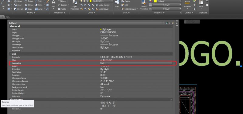

Dana W Posted November 12, 2015 Posted November 12, 2015 If it were "annotative" I don't see why you wouldn't know it.Because we're in the beginner's forum? I try to ask if the gas tank is empty first, then get to the hard stuff. I mentioned it because there is an OOTB annotative test style already set up these days, and beginners will use it without knowing what it is. When exploded, which removes the annotative properties, annotative text can change size if the current view annotative scale is different than 1:1 at which annotative text height is usually set by default. The annotative scale in modelspace can be changed at will, probably so the user can view annotative objects at viewport scale without going to the layout tabs. It will also move to its original position. Annotative text objects can be moved to different positions for each scale in the different viewports, so it will jump to its original location after losing the annotative property. To the OP. To find out of your text is or is not annotative, select it, and check PROPERTIES, look here..... Quote
amcutem Posted November 12, 2015 Author Posted November 12, 2015 Thanks Dana. That's the answer help I was looking for:D Quote
