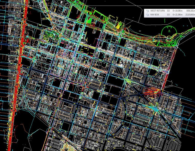

BIGAL Posted November 11, 2015 Posted November 11, 2015 Have you contacted maybe some other design or manufacturing companies to see if they have a large printer or even A3. Make a pdf then you can print to probably any printer at what ever size you like. Next if you find someone, do not jump to a A1 as a pdf a A3 can be very good even blown up to A1, A big A1 high res is a huge file at times and takes a long time to print. A municipal plan if it does not move its in the plan and its true XYZ Quote
