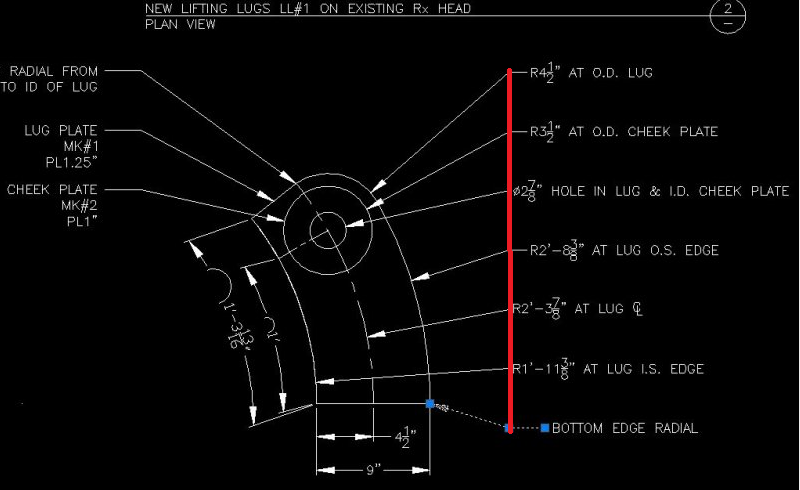

ColinPearson Posted November 5, 2015 Posted November 5, 2015 Hello world. Looking for a bit of help here on these dimensions... Most are radius dimensions and one is a diameter, all have the same dimension style. I snapped a ray from the vertex of one leader and then snapped each dimension's grip to that ray so they all line up (cause I'm OCD like that). Anyone know why some have the horizontal portion of the leader and some don't? Thanks! Quote
Dana W Posted November 6, 2015 Posted November 6, 2015 The nearest I could ever figure is that AutoDesk apparently thinks there is a minimum angle below which the leader "landing" is visually useless. You will notice that the landing'less leaders are all the flattest angles. It is just a guess, because this behavior is not an adjustment in the style editor, at least not that I could ever find. Another thing that happens is that below a certain length, the leader arrowhead disappears. Quote
RobDraw Posted November 6, 2015 Posted November 6, 2015 As demonstrated in the sketch below, the start of the landings appear to have been lined up. It looks like the text for some of them was moved closer to the left but the landing was not. My OCD tells me that the text should all be lined up with landings all the same size. Similar to what you have done for the left side. Quote
Dana W Posted November 6, 2015 Posted November 6, 2015 As demonstrated in the sketch below, the start of the landings appear to have been lined up. It looks like the text for some of them was moved closer to the left but the landing was not. My OCD tells me that the text should all be lined up with landings all the same size. Similar to what you have done for the left side. On second look, yes. The landings are not a fixed length, which can be fixed in the editor. This will cause them to disappear when the text is moved too close. Quote
ColinPearson Posted November 6, 2015 Author Posted November 6, 2015 Hmmm. Thanks for your input here folks. I see the fixed length in the dimension style editor Dana was talking about, but that does not seem to be fixing it for me. It does seem to really depend on the angle. I think I'll let this one go today... sometimes the box behaves and sometimes it doesn't. Quote

Dana W Posted November 7, 2015 Posted November 7, 2015 (edited) I use mleaders w/ text or blocks because two entities to me are one too many. The trick to mleaders is keeping them simple. Use a fixed length landing and a fixed length landing gap, with only ONE maximum leader point. landing attached middle left top line, and middle right bottom line. Text justified top left, which auto changes to bottom right when the text is dragged more than 90 deg, left of the arrowhead. My landings do not disappear, even at 0 deg., because the landing and landing gap distances cannot be altered. You want OCD? The client template I am using at the moment requires paperspace (hate 'em) dimensions and mleaders, so I have developed the habit of using the edge of my viewports to snap my mleader text box to so I don't have to erase it. OCD has also required me to learn some uncommon methods to align viewports vertically and horizontally so the mleaders on every viewport align with each other. Once the leaders are aligned, I may or may not move the viewport boundary to expose just the right amount of the model. Even with OCD, in architecture (Orlando, FL entertainment industry type) they still come out looking like a rats nest when one is forced to fill in most of the information on one view, ostensibly for proof of concept in this first iteration. Personally I think the theme park gods just like to make us normal humans draw the same stinking scene 4 or 5 times, and then rip it all down in 5 years to make way for the next blockbuster movie theme. At least most of the doors and windows are inoperable, and nothing is exposed to weather. Nothing much lines up in that drawing because I had nothing but the following sketch and a deadline to go by, so I traced it to the nearest 1/2 inch. The sketch was how a revision to the door trim and adding a stained glass window was presented to me. test shot.pdf test shot two.pdf Edited November 7, 2015 by Dana W Quote

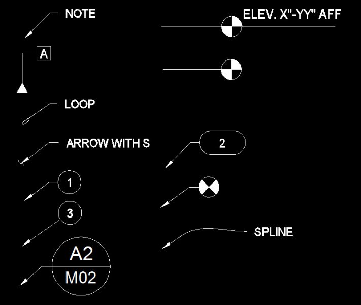

Dadgad Posted November 10, 2015 Posted November 10, 2015 I do a lot of leaders and am still not associating them with text. I find it just as fast to create two entities the way I need them as it is to fumble with styles, settings, grips, and justification. That is me and others would disagree strongly. That was how I enjoyed doing them, you likely recall the spline leaders which I favor. Now we are using ProSteel, and they make me nuts, because I can't tweak them like I am used to doing. I have had to give up on making them look great, it just isn't in the cards. They used to look great! Quote
