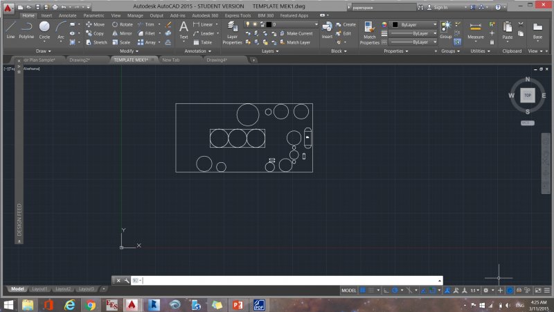

FloorPlan appears very small on Paper when printed and i need help correcting this..
Hi all, i am new to AutoCad and as the subject has mentioned, i cant seem to find anyway to correct the size of the plan it appears on the paper. Played around with scales but my it does not work at all.. i Have to submit in a day's time and really need help asap! :cry:

What size paper are you using? What are the overall dimensions of your floorplan? Indicate if you are drawing in imperial feet and inches, or metric mm, cm, M.
i dont know the exact dimensions as i merely drew straight away. they are in mm though..
Go into modelspace, start the DI command, pick a point to the left of your floor plan, then pick a point to the right of your floor plan. What is the X length?
Go into paperspace, start the DI command, pick a point to the left of your title block, then pick a point to the right of the title block. What is the X length?
x is 49.99
y is 24.97 These are for my floorplans
x is 97
y is 74 These are for the block title

i simply drew a rectangle and then created some other things within it and when i went to the preview section, i realised it was extremely tiny on the paper
Did you draw the floor plan using measurements/units at full size in modelspace.
  Inyenzi said:
[ATTACH]55971[/ATTACH] yeap here it is
Nope, there it is not, that is a picture. Post the dwg file so we can see what is up with your units and paperspace scale properties. We can't fix a picture of your drawing, or advise you what to do with nothing to go on.

yes i did. onscale of 1:1
Then you are saying you drew the plan at 49.something millimeters on purpose?
A scale of 1:1 will work for those dimensions.
No i basically just wanted a rectangle so i didnt really care about the dimensions
Your layout dimensions are more like 8x6, so a scale of 1:10 will work. If you aren't drawing to true size I am not sure worrying about scaling the viewport really buys you anything. Just zoom until it looks good and print.
OK then, give me a couple minutes. You have nothing set up on your page layout, no plotter, no plotstyle, and other things are checked wrong. I will set one up for you and post the drawing back here.
The first problem I encountered is that your drawing units are inches and you assumed they were millimeters. I am going to leave that alone for now since you didn't draw to scale anyway,
What size paper do you intend to use?
