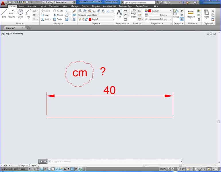

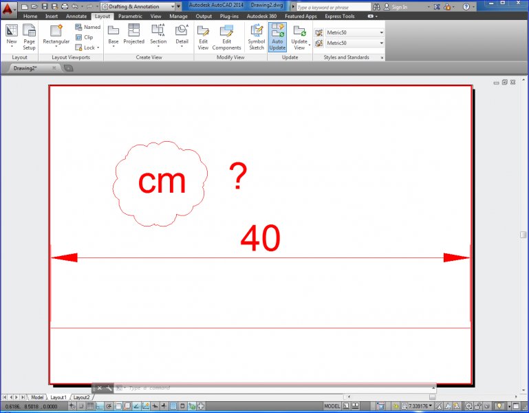

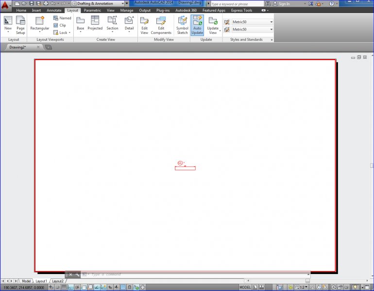

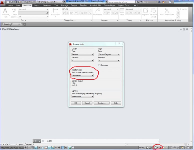

luchoab Posted October 27, 2015 Posted October 27, 2015 Hi,I am beginner in autocad and need some help ,please.I can't understand plotting with scale.Here in attached files I am showing what i am doing but there is any mistake I can't find.I prepared Model space to draw in centimetres and drew a line 40cm long.I prepared Layout at A4 and made a viewport.What I saw I think is wrong.A line 40cm long must be seen at scale 1:2 at A4 occuping 60% of the length of a paper A4 which is 29,4cm.What is wrong?Please help! Quote

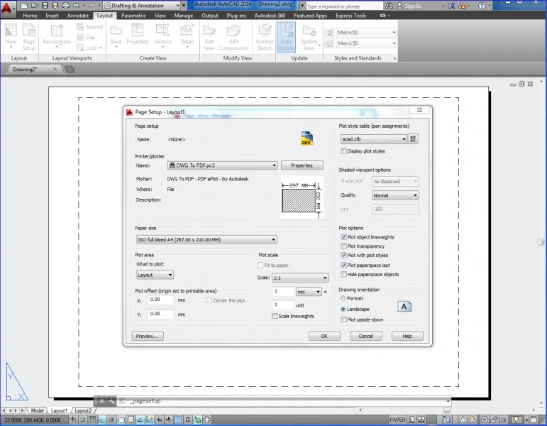

ReMark Posted October 27, 2015 Posted October 27, 2015 I'm guessing you used the default template to start your drawing which, as it turns out, is set to use decimal inches. The template file is named acad.dwt. The one you want to use since you are working in metric units would be named acadiso.dwt. Note that this template file is set to use millimeters as its default but can be changed to another metric unit via the -dwgunits command. Quote
luchoab Posted October 27, 2015 Author Posted October 27, 2015 I'm guessing you used the default template to start your drawing which, as it turns out, is set to use decimal inches. The template file is named acad.dwt. The one you want to use since you are working in metric units would be named acadiso.dwt. Note that this template file is set to use millimeters as its default but can be changed to another metric unit via the -dwgunits command. Thank you for the quick replay.I am using acadiso.dwt.Is it wrong? Quote

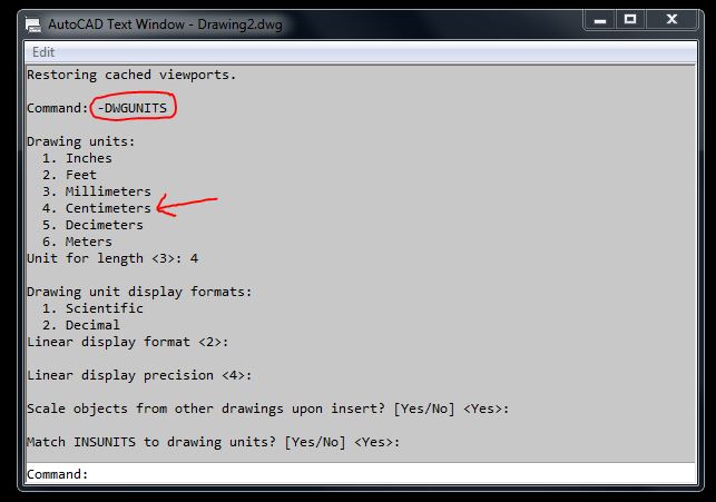

ReMark Posted October 27, 2015 Posted October 27, 2015 (edited) You are using the correct template but you are drawing in millimeters. Use the command -dwgunits and reset it to use centimeters if that is what you want to draw in. You'll have to redraw your line. Edited October 27, 2015 by ReMark Quote

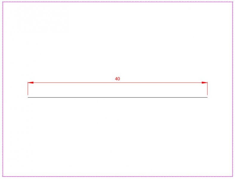

ReMark Posted October 27, 2015 Posted October 27, 2015 Should come out looking something like this: My viewport, in magenta, has been created on its own layer. Quote
luchoab Posted October 27, 2015 Author Posted October 27, 2015 Thank you.This is the solution.But must I make this settings every time I start drawing?These units in my first picture are useless!Are they useless? Quote
ReMark Posted October 27, 2015 Posted October 27, 2015 Are the units useless? Only if you never want to draw using millimeters. Must you change the setting every time you start a drawing? No. Set it and forget it by incorporating the change in your custom template file along with everything else you normally like to use such as linetypes, text styles, dimension styles, layers, multileader styles, etc. Quote
rkent Posted October 27, 2015 Posted October 27, 2015 The only thing wrong was you used an A4 border drawn in mm while you were drawing in cm, so rather than a scale of 1:2 it needs to be 5:1 to account for the difference between a mm border and a cm model space. Quote

steven-g Posted October 28, 2015 Posted October 28, 2015 Unfortunately for all the advances in Autocad, scaling remains a problem. You set your units correctly in model space to centimeters, but paperspace always remains millimeters and the standard scale list remains 1 paper unit= 1 model unit, which is 1 mm = 1 cm or in your case 1:2 1 mm = 2 cm (which means 20 mm = 40 cm). Just to confuse you even more keeping the notation used by Autodesk you should really choose the scale 5:1 (which isn't included) as rkent has said. One way to fix this is to use one scale from the list and write a different value in your title block, or alternatively edit all the standard scales in the list taking into account the proper units and then save this as a template file. Quote

rkent Posted October 28, 2015 Posted October 28, 2015 I would agree but apparently when we transition to AutoCAD / paper space / viewports, at least for metric drawings, the scale is 5:1 not 1:2. I'm been doing it wrong it seems. Glad I don't work in metric units. The problem arises when we mix cm (MS) and mm (PS). If MS and PS are both mm then the 1:2 works, but with MS as cm then you have to adjust by a factor of 10. Quote
rkent Posted October 28, 2015 Posted October 28, 2015 Hi rkent,I didn't understand what do you mean.I am thinking this way:1.I draw a line 40cm long 2.When create dimension the text of dimension must be 40 3.After plotting at A4 when I measure the line 1cm will correspond to 2cm of real drawing at Model space. Do I make any mistake? That is correct. Quote
luchoab Posted October 28, 2015 Author Posted October 28, 2015 At the end I understood.I don't set anything in Model and in Paper space scale 5:1 is what I want.It's 1:2 on a paper sheet.Thank's everybody. Quote
