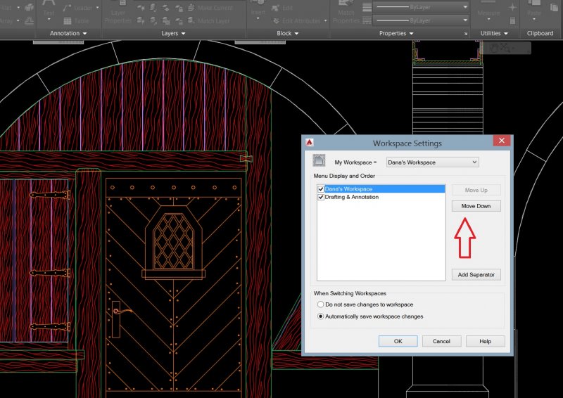

Dana W Posted October 22, 2015 Share Posted October 22, 2015 You have to move the desired workspace to the top of the list of workspaces, so it will be the "default". Quote Link to comment Share on other sites More sharing options...

Dana W Posted October 23, 2015 Share Posted October 23, 2015 ... and changing the order under Workspace Settings has nothing to do with it. You are probably right about this. Except, on day one of creating my workspace, I could not get AutoCad to default to opening in My Workspace until I moved it to the top of that little list. Then, thereafter it opens in My workspace, EVEN if I move it to the bottom of the list. Quote Link to comment Share on other sites More sharing options...
SanMiguel Posted October 23, 2015 Author Share Posted October 23, 2015 You are probably right about this. Except, on day one of creating my workspace, I could not get AutoCad to default to opening in My Workspace until I moved it to the top of that little list. Then, thereafter it opens in My workspace, EVEN if I move it to the bottom of the list. Putting up the list wouldnt do nothing, It would only show first in order from the pull down menu workspace. Quote Link to comment Share on other sites More sharing options...
Dana W Posted October 23, 2015 Share Posted October 23, 2015 Putting up the list wouldnt do nothing, It would only show first in order from the pull down menu workspace.Yeah, I can't get it to show any effect now either. Maybe I am just remembering a coincidence between moving to the top of the list and setting as current, or some other completely incomprehensible combination of AutoCad options. Quote Link to comment Share on other sites More sharing options...
