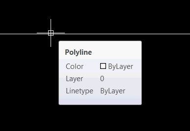

I do not know what it is you call "rollover menu" but I think it's Dynamic Blocks you should look for.

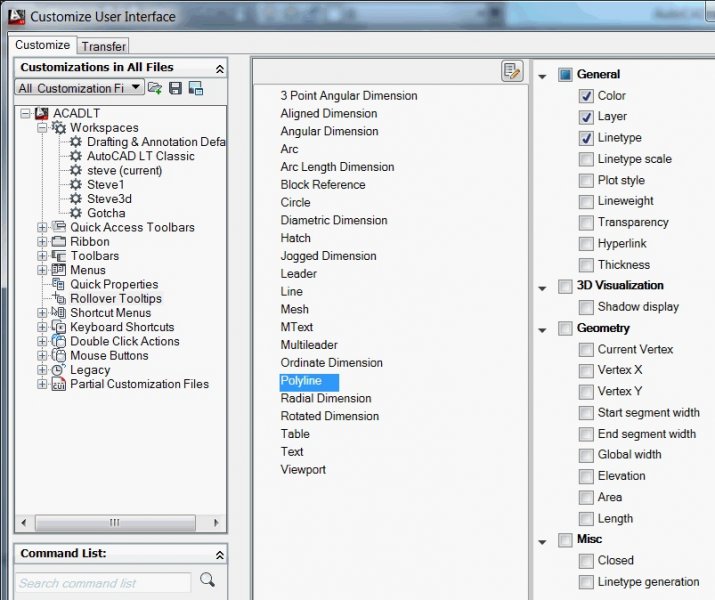

If you mean the properties as shown in the second image.
You can choose the options in the CUI (first image) but I don't know if you can add custom properties.

steven-g : I don't mean the menu shown in the second image exactly, which is the "Quick Properties" menu and only a part of what you see in the "Properties" menu. Both can be configured as you said by using the CUI and choosing only a set of pre-existing properties, but what I want to know is if there is a way to create custom properties and display them in those menu ?

The image I gave is the "rollover tooltip" which is different to the Quick properties, which is again different to the Properties toolpalette. I think the simple answer is no you can't just add custom properties, you can change the object into a block and use attributes to hold further information, or another possible option would be to Hyperlink a document to objects and store any other data that way. It depends on what you are wanting to do.
