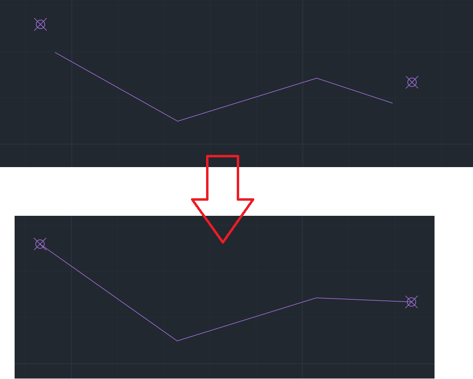

Hello! I've found this lisp, endsnap by Lee Mac and it works perfectly. Thank's for that Lee Mac.
I'm trying to find a lisp that does the same thing, but with polylines, working only in the edges (polyline endpoints). It's possible to modify this endsnap lisp to do that?

I'm pleased that you find this program useful :)
The code could be modified in the following way to incorporate support for (LW) polylines:

Thank you so much Lee Mac, grateful for that, works perfectly!!
Best Regards!

Is there a way to tweak this so it only looks for lines on a specific layer and moves the end point to the nearest node? I have a Pline on a layer called P-FBER-DROP. I need to snap the end points to the nearest node that has been placed in the center of a closed polygon

Certainly - change this line:
(if (setq sel (ssget "_:L" '((0 . "LINE,LWPOLYLINE,POINT"))))
to:
(if (setq sel (ssget "_:L" '((-4 . "<OR") (0 . "POINT") (-4 . "<AND") (0 . "LINE,LWPOLYLINE") (8 . "P-FBER-DROP") (-4 . "AND>") (-4 . "OR>"))))

                   (if (< (setq di2 (distance pt1 pt3)) di1)
                       (setq di1 di2
                             pt2 pt3
               (entmod (subst (cons (caar itm) pt2) (car itm) (entget (cdr itm))))
Expand
Hi, Lee Mac,
Is there a way the lisp shift only one end of the polyline to the nearest point. Presently it is moving both the start and end point of a polyline to the selected point. (My point has z value and the polyline is on 0 elevation)
Thanks
Yes - simply comment out (cons (assoc 10 enx) ent) or (cons (assoc 10 (reverse enx)) ent) depending on which end you don't wish to move.
