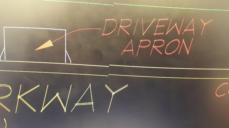

Crazy Lines! Has anyone had this issue, or know about it?

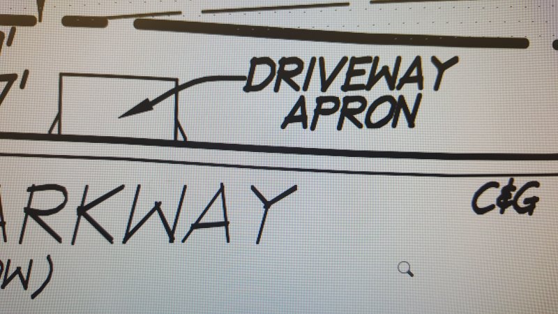

I am going to attach two pictures. The first picture shows what the line work looks like. The second picture shows what the printed/plotted result shows. The break occurs on both polylines as well as lines/arcs at certain endpoints. The objects have no elevations. My boss and I found this really odd because the printed/PDF result does not show the same. Is this possibly a glitch? Maybe, this post should be in that forum instead of the Civil one (If thats the case would one of you moderators be so kind as to relocate this post?) Civil just happens to be the version I use. Let me know what you guys/gals think. I'd love any and all input. To quote a wise man from here cheers :beer: LOL

The attachments didn't work, at least not here.
Does a regenall fix it for a while? What is viewres set to? Try a setting of 5000 or higher and see what happens. May be a Civil 3D issue as you guessed.
I have already tried those. Did not fix it. When a regen is run it does not fix it at all
can you post the drawing file?
Change your WHIPARC variable to 1.
Regen
I cannot post the dwg due to the content of the drawing
You don't have to send the entire drawing, just a few lines that exhibit the behavior.
Uhhh, very good point kent haha. I will do what I can when i get a chance.
I have no idea what happened but i cannot get the issue to occur again. Guess I'm going to chalk this one up to just an odd fluke.
