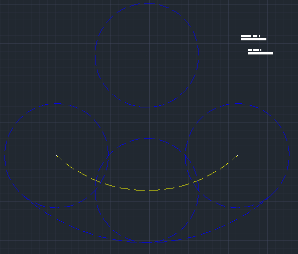

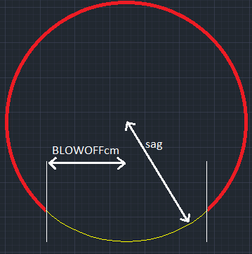

Hi, I am looking for a way of limiting the length of an arc (using AutoLISP), that has a set center point and a set radius, along the x-axis?
No idea what you want, need a picture. An ARC is not a circle if its less than 359.99999 degrees
Edited by BIGAL
The red line is the part to be removed and the yellow arc length needs to be restricted by the BLOWOFFcm where the radius of the arc is sag.
Also, the two white lines that are present won't be in the final script.
I have posted my script below.

Also, how can I create an additional point at each end of the yellow arc?
Thanks for any help :)
Tried you lisp, but still not sure what you're trying to do. Rather than drawing a circle and trimming it why not just draw an arc? Since sag²-BLOWOFFcm²=dy² and BLOWOFFcm/sag=cosine of ½ arc angle it should be simple enough to draw the arc and endpoints.
I had tried creating an arc using two points but had the problem of it not having the sag as a radius. (I have removed it from the code as it started breaking it and I though about using a circle and trimming it)
;; Draws arc from arcpointright to arcpointleft through arcpointmiddle on the new layer
(layer_set "Continuous" "50" "DASHDOT")
(command "._CIRCLE" originalwire sag)
;(command "._ARC" arcpointleft arcpointmiddle arcpointright)
I'm not really sure how I would implement your suggestion as your equations are confusing me a bit :cry:
Your arcpointleft, arcpointmiddle, and arcpointright points do not make an arc. Try using
 (command "._Line" arcpointleft arcpointmiddle arcpointright "")
to place a line between those points in the drawing to see they make a straight line. You cannot draw an arc with three points that produce a straight line. None of them are one the circle either. Arc command will work if you calculate those points correctly. Since BLOWOFFcm is the dx for the endpoints and I showed how to get the dy for the endpoints above all you have to do is subtract the sag value fro the x value of originalwire to get the arcpointmiddle point.
That makes sense. Ill implement that now and see how it goes.
That worked a treat thanks tombu!

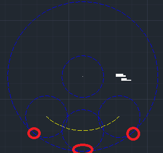

How would I get the bottom arc to tangent the 3 circles? I could set a point at the bottom of the middle circle but what about the two at the sides?
I did it in the picture by:
(layer_set "Continuous" "50" "DASHED")
(command "._ARC" arcpointleft arcpointmiddle arcpointright "")
;; Sets another set of points for the clearance arc
(setq clearancearcmiddle (polar arcpointmiddle 4.7123889803846898576939650749193 66))
(setq clearancearcleft (polar arcpointleft 4.7123889803846898576939650749193 66))
(setq clearancearcright (polar arcpointright 4.7123889803846898576939650749193 66))
;; Draws clearance arc
(command "._ARC" clearancearcleft clearancearcmiddle clearancearcright)
Assuming those three circles have the same radius just offset the first arc by that amount. I would entmake another arc using the entget entity list data from the first with the modified radius. Take a look at the DXF group codes for an arc entity. As I remember all you need to entmake the arc are the Center point, Radius, Start angle, and End angle.
I can't get the arc to work correctly, i can do it by using the circle command but I don't need the excess circle beyond the 3 smaller circles.
I would like the arc to be tangent to the 3 circles at the red areas highlighted but also end at the two circles on the end.

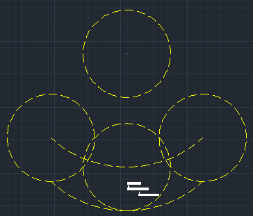

This is what I have managed to get but using the circle command:
(command "._CIRCLE"     originalwire (+ sag 66))
This is the circle I get:
I managed to get the arc by creating points at the circle tangents:
;; Sets temporary points for the clearance arc
(setq edge1 (polar arcpointleft 3.979350694547071435386014952154 66))
(setq edge2 (polar arcpointright 5.4454272662223082800019151976845 66))
(command "._ARC" edge1 clearancearcmiddle edge2)
Thank you for all of your help tombu and BIGAL, you have helped me out loads!
