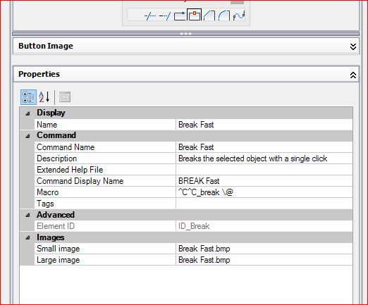

Dadgad Posted October 14, 2015 Posted October 14, 2015 I have taken a screenshot of how the command looks in my CUI. Works great. Quote

rock1 Posted October 14, 2015 Author Posted October 14, 2015 I have taken a screenshot of how the command looks in my CUI.Works great. Now I modified my existing break command using your thing. If I always click the toolbar button for break, the command never asks for a point to break, it breaks nearby where I click the object that has to be broken. Should I make a new command and a toolbar button for that? Quote
Dadgad Posted October 14, 2015 Posted October 14, 2015 I think it is a better idea to create a copy of the BREAK icon on your modify toolbar or panel, and change the bitmap (icon) a bit from the stock one. This link will show you how Lynn suggests doing it. http://lynn.blogs.com/lynn_allens_blog/2012/01/an-autocad-hip-tip-on-speeding-up-the-break-command.html Quote
rock1 Posted October 15, 2015 Author Posted October 15, 2015 I think it is a better idea to create a copy of the BREAK icon on your modify toolbar or panel, and change the bitmap (icon) a bit from the stock one. This link will show you how Lynn suggests doing it. http://lynn.blogs.com/lynn_allens_blog/2012/01/an-autocad-hip-tip-on-speeding-up-the-break-command.html I know how to make custom toolbars and buttons. But that's not my requirement. What I need is a custome keyboard shortcut via editing the .pgp file. What I have seen is the command breaks the line or object at a point which is nearby where I click with my square shaped cursor. I don't get a crosshair to point out the precise point where I need to perform the break. What should I do? And the command works through toolbar only. If I use my keyboard, the command asks for me to specify a second breakpoint always instead of the only point and I get is a break at two points not at "one" point. What should I do? Quote
steven-g Posted October 15, 2015 Posted October 15, 2015 You can not alter the core command, and command alias's only work for core commands, so what you want to do, can not be done. The closest you could get to that would be alter the macro in the CUI, so as already discussed, then copy that command to the shortcutkeys menu in the CUI and from there assign a keyboard shortcut to the command, but that has the added limitation of only working in combination with using the shift or control key. Or use LISP. Quote
