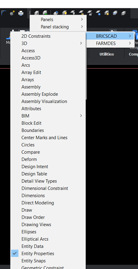

BIGAL Posted November 6, 2021 Posted November 6, 2021 (edited) Download a trial of Bricscad and have a look at it, out of box may not have toolbars displayed so type -toolbar nameoftoolbar show eg -toolbar draw show once you have 1 toolbar you can add as many as you like right mouse click on the right end the 4 vertical dots then can open more. Almost forgot RIBBONCLOSE does just that RIBBON will reopen the ribbon. For me given the option buy cad software with no customisation like lisp or buy one with that ability. A task takes 20 minutes I do the same in about 20 seconds. Edited November 6, 2021 by BIGAL Quote

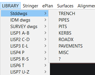

BIGAL Posted November 8, 2021 Posted November 8, 2021 I made custom toolbars for CIV3d saves like 3 steps when working with display surface styles. Custom icons are easy to recognise. I still find using CUI to make ribbons a pain. Have looked at making XML via a lisp. Copy cuix rename to zip have a look. Quote

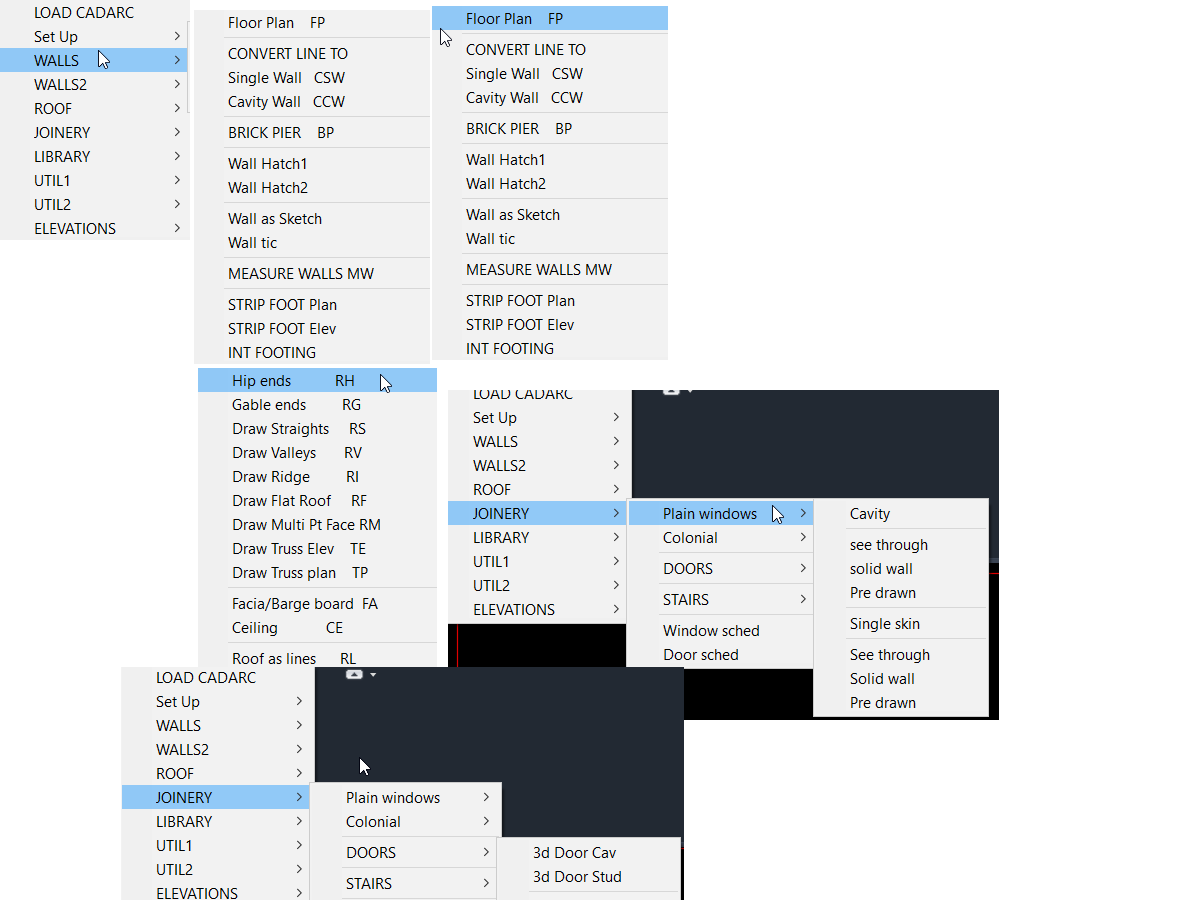

BIGAL Posted November 11, 2021 Posted November 11, 2021 Masetrfal custom toolbars and pop menu's are the way to go this way just have the options you want to use all the time. Make them with notepad very easy. Check this one out shows sub menu's Quote
masterfal Posted November 11, 2021 Posted November 11, 2021 yeh see that looks like way to many menus clicking/moving through to be finding things.. i'd set up keyboard shortcuts for all that stuff. granted, the list of commands can become mighty lengthy but if set them in a way where they're in some sort of system / pattern then easy to remember. like most of my hatch commands start with a h. hw for hatch wall, hs for hatch solid etc etc all my multileader commands all start with an l. la for leader with arrow, ld for leader with dot, ln for leader with none etc etc all my numbers are set to the cad colours so using 1 on an object will make it red, using 2 will make it yellow etc etc the above is all just personal opinion of course. Im guessing those abbreviations in menu are the keyboard shortcuts? i like how you've shown them in menu Quote
