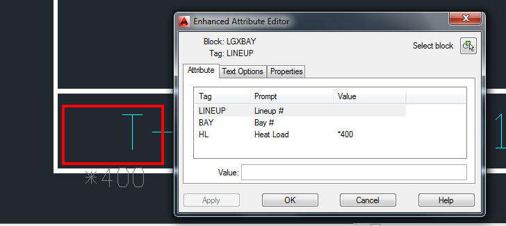

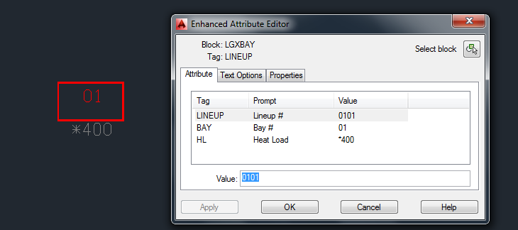

I am a complete newbie for AutoCad and AutoCad.NET. I am stuck with a problem. I am asking the user to select a block reference which has three attribures namely LINEUP, BAY and HL. Then I am trying to create a copy of it. But the attributes LINEUP and BAY (Values of these) are not being copied. Can You please help me out with this issue.
Original Block With Attributes : See Image OriginalBlockWithAttributes.png
New Block Without Values of the Attributes : See Image NewBlockWithoutAttributes.png
