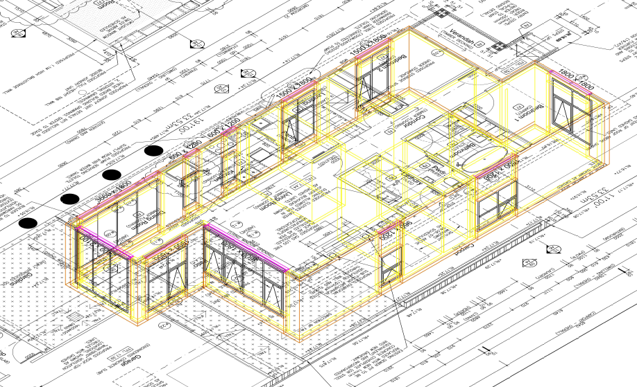

If you look carefully at this image the walls are 4 layers similar to the Mline, yes doors and windows break the walls. An option is draw an arc wall with the current wall settings. On that change wall thickness by just drag over an existing wall and sizes are reset no need to remember the name of the mline. That is an idea can get mline properties.
Yes Autocad Architectural killed the market for us. This is about 30 years old code.

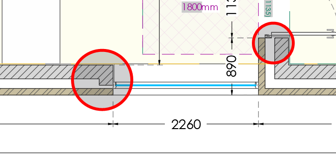

This is what I mean by different endpoints. It is athe  little bit more complex than those that program does @SLW210.
You should be able to design your own in a UI. ACAD should be that powerful, yet it isn't.
I'd use dynamic blocks for this but the stretch command doesn't stretch any dynamic object even though the stretch rectangle goes over the stretch grip of the block🥹

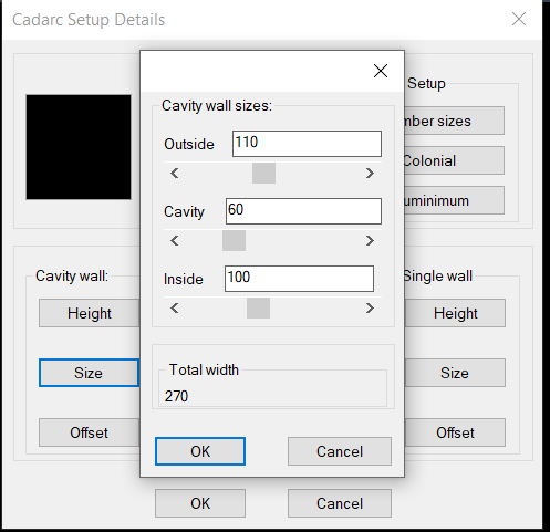

The one on right could be done, the code I have draws 4 lines continuously like mline could add a cap option for two lines. The one on the left would be say a second go editing the end.
Cool @BIGAL. It's that program available for purchase? I'd buy it in a heartbeat if it could return the inner leaf with the same 215mm thickness of wall leaving the 50mm I have shown on the left example for a 50mm strip of PIR board. Would that be hard to implement?
