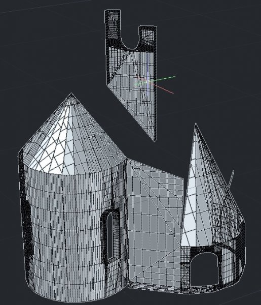

Hey guys, Im writing here cause I can't seem to find a solution. SO the problem is I got many 3dface objects in my drawing, and whenever I click them they show some sort of grid. So the question is: Is it possible to explode 3dface to lines with that grid also converted to lines?
Attached image for better understanding

You can't Explode a 3D Face, but you can convert a 3D Face to a Region which can then be Exploded.
