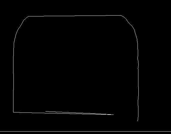

BIGAL Posted October 6, 2015 Posted October 6, 2015 I got this from your data it took a few seconds to do just used notepad to remove + and changed space to "," changed 006 & 007 etc to 000. Removed all notes from start of file added LINE as 1st line Ctrl A Ctrl C then pasted to Autocad command line. Just not sure if this is correct. Quote
geo1595 Posted October 6, 2015 Author Posted October 6, 2015 That's exactly how it is supposed to look. I just need a way of automating it for lots of drawings. Thanks, Quote
